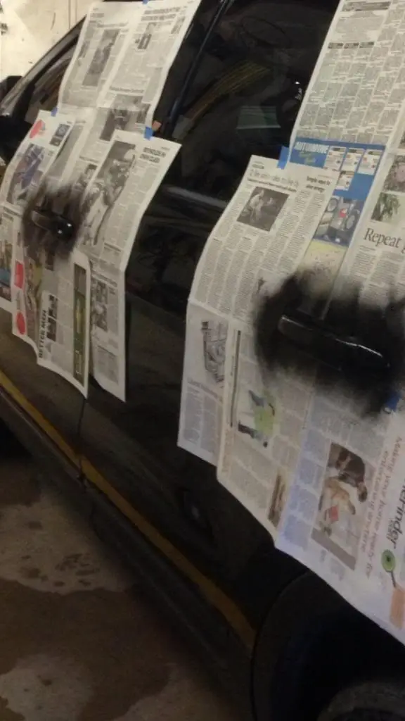

do you think it is safe to paint like this?? is the paper gets wet then what should we do? don't you think that we could use transparent plastics instead of newspaper??
I know this post is old, but since this thread is being updated, I figured I'd chime in with an answer for you. This should be totally safe. If they were spraying enough paint on to soak the paper, that would be the least of their worries - the paint would form all sorts of drip marks and be a complete wash on the handles. When spraying the correct amount, the paint should become tacky almost instantly and their should be no need to worry about it getting through the paper.

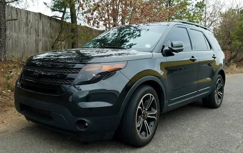

I took my Ford OEM black plastic door handles off my 14 Sport before trading it in for the 17.
These arent painted chrome or Ebay cheap ones these are from assembly line, OEM Front PEPS, and OEM rears.
If anyone wants to purchase for 1/2 of what they cost on Fordparts.com please PM me.
Thanks for the pic! Would you order the same one again?
