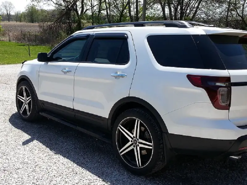

Just thought I'd throw this in. It is the door handle on my MKT. Something a little different.
Peter
