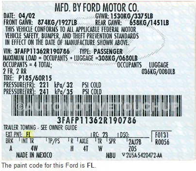

paint scuff..need OEM paint code for tan colour on Eddie Bauer 2010
Hi there...have tried rubbing it...but it has definitely scratch the paint :(
Call your local ford dealer and give them the last 8 digits in your vin...They can give you the paint code.
OEM paint code
thanks for the tip that is a great help :-);):exp:
I don't know if the sticker has trim codes, but you can look.
