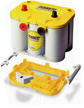

Some of the new Optima's come with adapters in the cover to adapt them to different battery trays.

Actually I purchased a Yellow Top battery a few years ago and like 90ranajo said, the adapters where hidden in the cover. If you don't have them, then take the battery back and tell them you have the wrong battery.

i just got a yellow top couple months ago and it came with the tray and adapters. i used the adapters but not the tray and all the factory bolts work perfectly
http://www.autobarn.net/noname3.html
the new adapter kit shown at the bottom of that page is what came with mine. i used the two long adapters and it fit like a glove.

Is this a newer style? I just bought a new yellow top today and it's adapters look nothing like these. I was gonna fab an adapter out of some black corian but if these new adapters match up perfectly then I would rather get that style. What size did you purchase a 34/78? It's not just the adapters that are different either. The whole bottom of the battery case is different then the one that I got.
I got one last week and had the adapters just like this.
Just used the grey triangle piece and the stock screw.
I should know better..... in my other post I mentioned about my new battery and hold downs were different........ well, it turns out, when the guy grabbed my battery off the rack he grabbed a D35 instead of the D34....... I usually always double check everything cuz i hate going back to the store to return incorrect stuff........... so now I do have correct battery with new style direct fit hold downs. Much , much better!!
