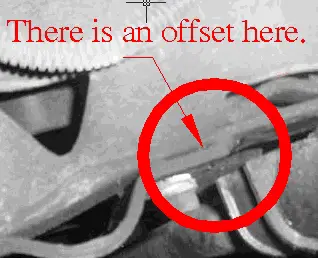

Looking again.....I think I see a possible reason. The factory bracket is stepped for the extra thickness on one side for the factory crossbrace up front. If you used a different sway bracket without the offset I wonder if this would have left a small amount of play and as the bar cycles hundreds of times I wonder if it fatigued the metal and well the picture shows the rest.
I hope this doesn't come off the wrong way because I'm not trying to be a smart### ( I was looking at some of my posts and I was a d*ck.... it must come natural??) but I think maybe this isn't the right bracket. The bracket doesn't have to be factory but it will probably need the offset in order to make the bushing sit flush, without any play.
