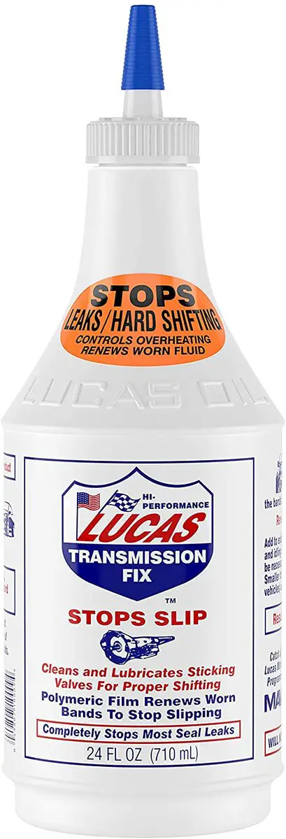

Probably too late with current symptoms but this stuff works minor miracles.... you'd need to siphon out some fluid to make room of course....(hand siphons $9 at Walmart) - Don't forget to check trans level with engine running. It's a 1 & 1/2 hour drive from where you are at but if this "temp fix it" buys you a bit more drivability Pasqual's Transmissions in Santa Ana will do a complete rebuild / de-install / installation all for around only $1,400 -- (714) 542-5150 Tell him a guy who's dealt with him / sent him other business gave you this close ballpark price.
**** makes a mess inside for the next rebuilder, but that messy coating is what is able to provide the tranny with many extra miles beyond.
