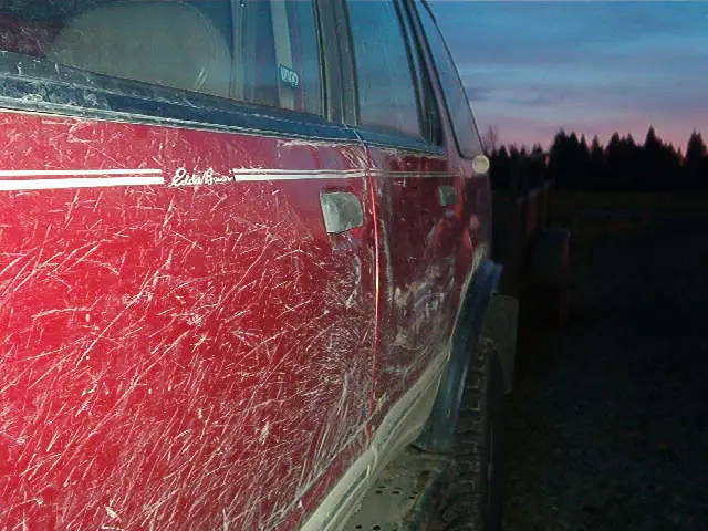

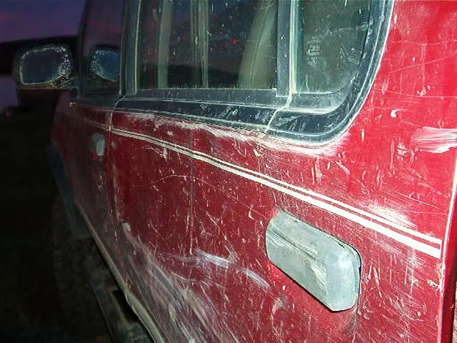

A open diff will help you from sliding sideways when you are off camber. when both of the wheels on a axle are spinning gravity wins.
A open rear diffrential would have helped prevent this (Elbe Hills pinstriping)
Ouch!!!! You just gave me all the confirmation I needed on the open vs. L/S debate!!!!!!!!
