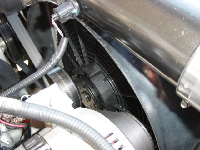

First would be the electric fan. Installation instructions provided byElectric Fan install

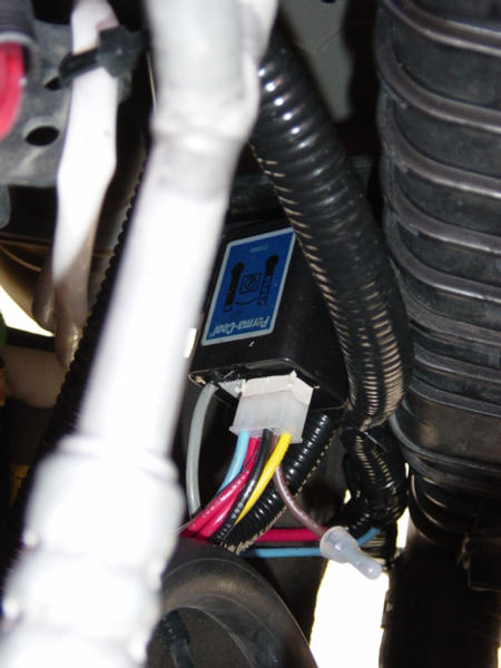

This is the Perma Cool thermostat

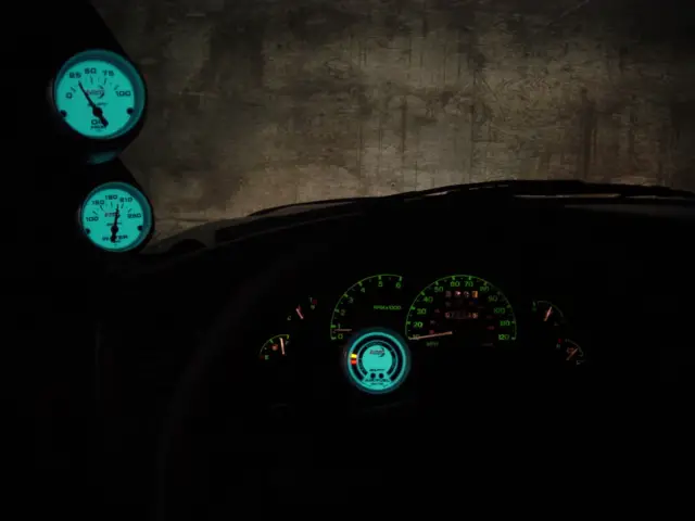

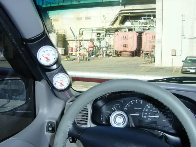

Wait there's more... Auto Meter Gauges In (Thanks Matt)

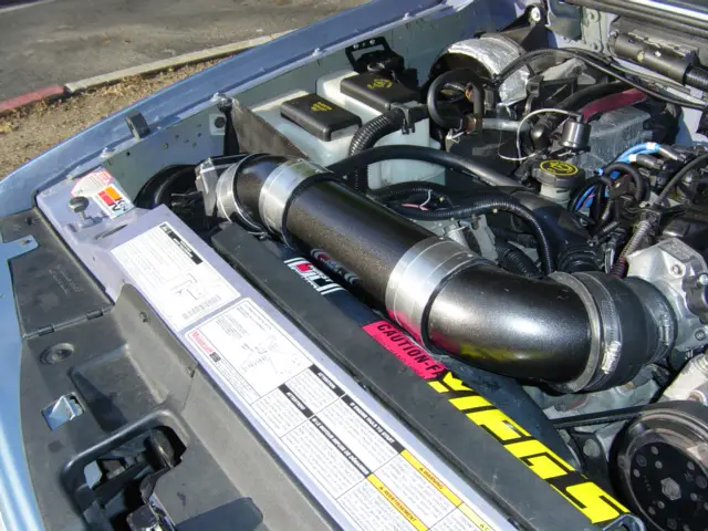

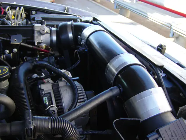

And Last but certainly not least... I rolled out another air intake. Took my first idea and expanded it a little. Nice huh?
So I guess that it's for this month. What do you think?

Could you tell me exactly what idiot lights the steering column gauge covers up?
wow.. u have been busy.. what did you make that intake tubing out of?
Very nice looking intake... how about a writeup

I'm loving that intake.... Looks sweet!!
How about some details!?!?
Idiot Light? Huh? What Idiot Light do you have down there.
Intake tube is made out of ABS plastic
Hey, are those the Ultra-Lite Autometer gauges? Cause that's what I'm thinking of getting.
They are the Auto Meter Lunar series gauges
I think a write up is due. I am perfecting this intake thing.
Alec your ABS, Airbag, Brake, Battery, High Beam, and left turn lights are all under or near the bottom of your tach.
I have reverse indiglows so i just went out to look
That's intersesting. I didn't know that. I guess my truck hasn't had the idiot syndrone yet.
Very clean job on that intake. Did you notice any difference by going with a bigger intake tube?
This is the second intake tube that I have done. You can check out the old one in my photo gallery. I don't think I noticed as much a difference as when I put on the open element filter. I like to tinker. I am frequent customer of Home Depot Racing Supplies.
Which model of the sterring column guage holder did you use. I need one of those. I've got more guages waiting to be installed, but no place to put them!
This was actually a discovery that Matt (Black Magic) made. Gotta give him props ya know. The F150 gauge pod pops right on. It comes in manual and auto steering colum types. Gauge Pod
Hey, is that a oil press gauge?
If so, where did you tee into?

ipozestu Looks like you have been busy! Everygthing looks great! Thanks for the credit and your welcome for the steering guage pod.
