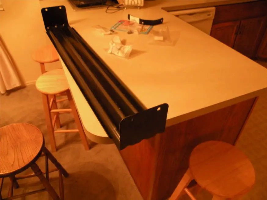

Just in case you fellas want to see (to do something similar), here's the transfer case skid plate.
Fuel Tank skid plate to follow eventually...
Just a height and width maybe a few other measurements...
It would be really nice to have all that great spec in one place for all of those with a welder and some fab skills(but limited funds) to really protect the undercarrige....

I'll try to see if I can get pics of my stock Skids. If that would help? They are still on my ex though so that's the best pics I'll be able to get.
Here you go, best I can do.
Fuel tank:
This is how its mounted on passenger side, bolted to frame.
This is driver side mount for fuel tank skid.
Dif: This is how it looks on there.
<-- where the to plates meet up.
If anyone has any questions about them ask away. I'll answer whatever I can.
Thank you so much this clears a lot up I couldn't figure how the hell they bolted up and now I can clearly see they bolt to the outside of the frame!

correct its 2, Transfer case and gas tank. The t-case is stamped 1/8" steel and the tank looks to be fiber reinforced plastic.
