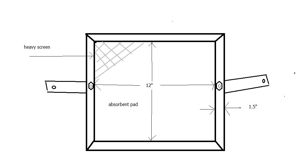

I made a square aluminum pan 1 foot square, 1.5" deep, and bolted to to a transmission bell housing bolt and starter bolt, then I put an absorbent pad in it, and covered it with a heavier mesh to prevent the pad from blowing out of the pan at highway speeds.

i imagine what they mean is they made 1 sq ft tray (guessing 3"x4") that is 1.5" deep, envision it like a 3d shape. use the imagination here, i dont have a pen and pad. then it was connected to a starter and bell housing bolt, both of which face the same direction, so its like a sink bolted to a wall so to speak. the rest is self explanatory. ;) let me draw out what i think really quick.

About once a month, sorry, no pics. it was about 3 inches below the bell housing, and away from the exhaust by 4 inches, I would check once a week to see if there was any liquid above the absorbent pad to know when the pad needed changing, the apartment didn't want any vehicles with oil leaks, I had it here without incident for 2 1/2 years before I tried the sealer, then about a year later the 98 Ranger was too rusty in the frame to bother fixing, so I sold it. I did a cheapie conversion from PVH hubs to manual also.
It was a whole lot less work to make the pan, than to replace the rear seal.
Edit it was only making 3" oil spots on the parking lot, so I used pizza boxes until I made the pan
@spetersen I could see that working. I would add to it, criss cross bungee cords to support/secure the pizza box under the vehicle and use zip ties through the pizza box around the bungee cords. I wish that I knew how to draw on this laptop, but I don't. Maybe you could add to drawing for me. User change box as needed.
