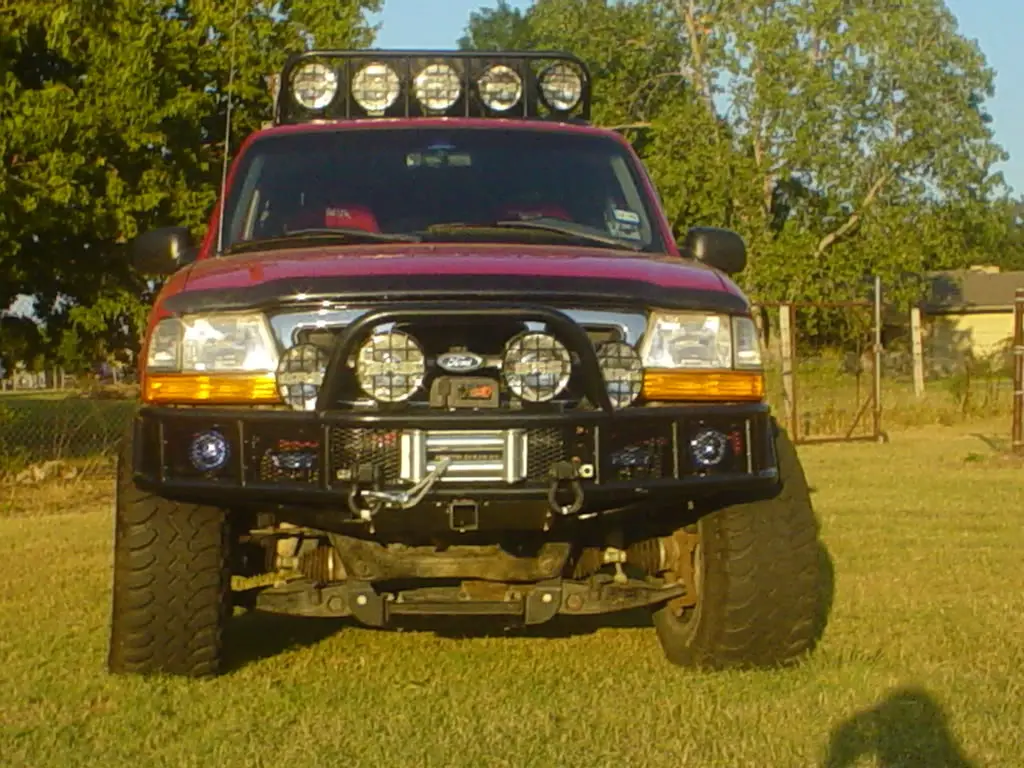

So i love craigslist i found a nice pair of black 15x8 rims on there with a 3.75 back spacing. for $100 (hopefully get for 60 or 70) great right?? well they are 5 on 5.5. so i would need adapters.
ebay has some buy basically the lowest i could go would be about 1.25 inch spacing for the adapter.
how crazy would i be to run a week with adapters at 2.25 backspacing?
the reason i ask is i want to get a new set of 15x8 however and put a set of 33x12.5x15 on there. for me to get a new set online would be $60-$100 a pop. so $400+ shipping. i could get away with these wheels for say $70+ $120 for spacers. is it worth saving $150???
i understand back spacing and i have heard the stories that it will wear stuff out quickly but how quickly are we talking? is it like 40,000 miles quicker? or more like 10,000 miles quicker?
so yea please please please give input... if i dont get these i would just get some 15x8 with 3.00 BS
