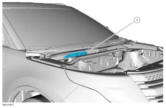

Did you locate the PCM?
You're welcome and good luck!
I did not see it there (photo below) but did not remove the batting yet to see if it is behind.
Honestly, I am 90 minutes into the manual and still have some more remedial studying to do from it before I get too far. When you mentioned a scan tool, did you mean my $20 Walmart OBDII device, or something more complex that connects to a laptop or phone? The manual refers to a network scan for DTCs and sounds sophisticated.

I also removed the windshield cowl to get to the PCM and found a pile of pink insulation bits arranged in the void near the outlet for the windshield vent. Despite the suspicions forming in my mind as I was cleaning it out, I was still surprised when I saw out the corner of my eye the owner tiptoeing across the battery. Sadly (for the mouse), he met his demise last night. I'm still looking over the wiring, though I do not see any obvious signs that it was chewing on things.

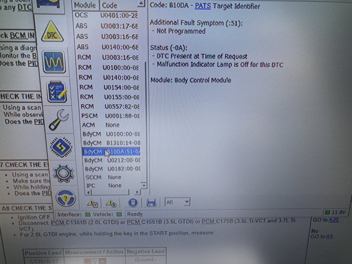

I finally have a working setup for Forscan, which, after some fiddling, found a bunch of DTCs. Only one is marked as "Present at time of request" and that is for PATS:
The service manual says this about that code:
B10DA:51
PATS Target Identifier: Not Programmed
There is no PCM identification stored in the BCM . CARRY OUT a parameter reset.
For vehicles without Intelligent Access, REFER to Section 419-01B, Passive Anti-Theft System (PATS) Parameter Reset .
And the reset procedure looks like this:
  1. Turn the key from OFF to RUN.
  2. From the scan tool, enter TOOLBOX. Select Body>Security>PATS Functions and follow the IDS on-screen instructions to enter PATS security access.
  3. NOTE: If the BCM was replaced, at least 2 keys must be programmed to the BCM . After completing step 3, leave the scan tool connected and REFER to Erase All Keys and Program Two Keys .
    From the scan tool, select "Parameter Reset" and follow the IDS on-screen instructions.
Forscan did not let me "Erase and Program Keys" because it says there are none stored. When I tried to do "Ignition Key Programming," I kept getting an error that it failed. The log says "Number of keys stored is zero" and "No key detected."

I think you and Peter are right about my vehicle not using PATS, though I’m still confused about why Foscan is finding a PATS-related code. Maybe that is a question for the Foscan folks.
First, I’ll go back and play with the Tremco device some more and see if I can get a wiring diagram. Maybe running Foscan again with the Tremco back in place will shed some light.
