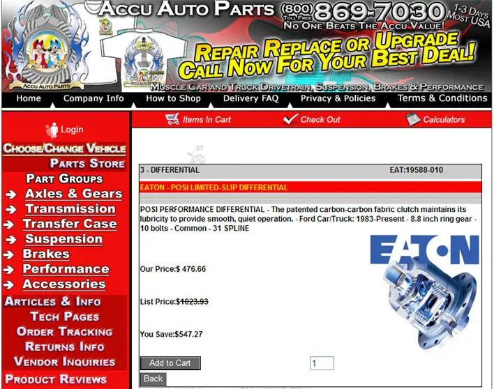

I found this. Am I getting the entire housing (easy swap) or just the internal parts?

Unless you want to set your gears up twice (or pay to have them set up twice), you'll want to do it at the same time. If you install the posi unit with your stock gears, you'll have to remove your ring gear from the stock carrier, install it on the eaton unit, and set your gears up. Then, when you decide to change gearing, you'll have to remove the stock ring gear and install your new ring gear on the eaton unit, change the pinion gear, and set up again.

As LBarr2002 said, do it all at once to avoid having to set the gears up twice.
Also...right now Dead Link Removed is having a 10% off sale on their posi units. Their website says to call for details. The regular price is $487.95, so you might get a better deal there. Randy's is also a reliable company to do business with. I don't know anything about the company you have listed.
