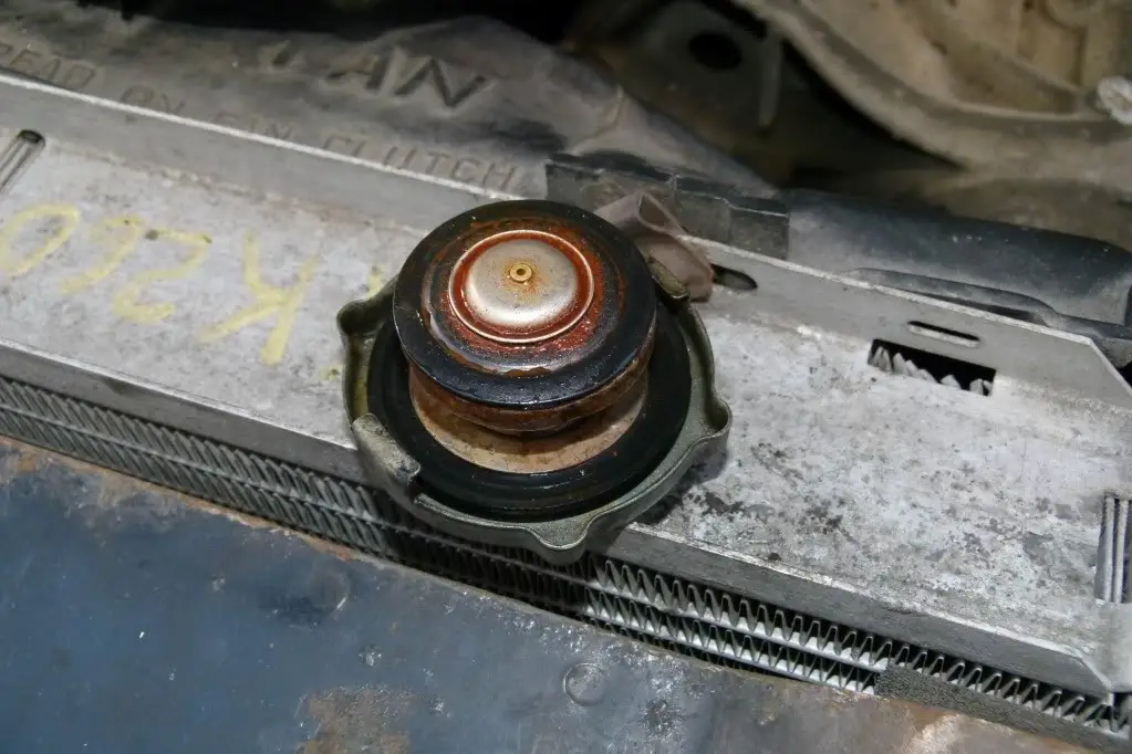

What does the inside of the radiator look like?
The reddish color you see in the neck and on the cap is what it looks like in the top of the rad when no coolant is in it (along the sides and on the trans cooler that you can see on that side).

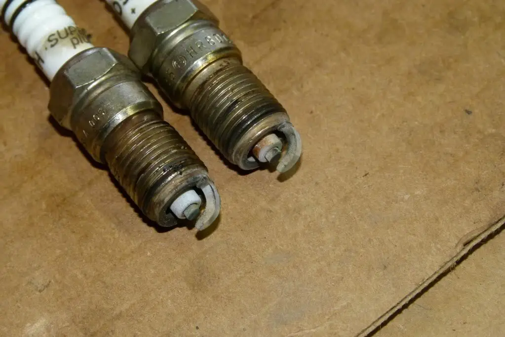

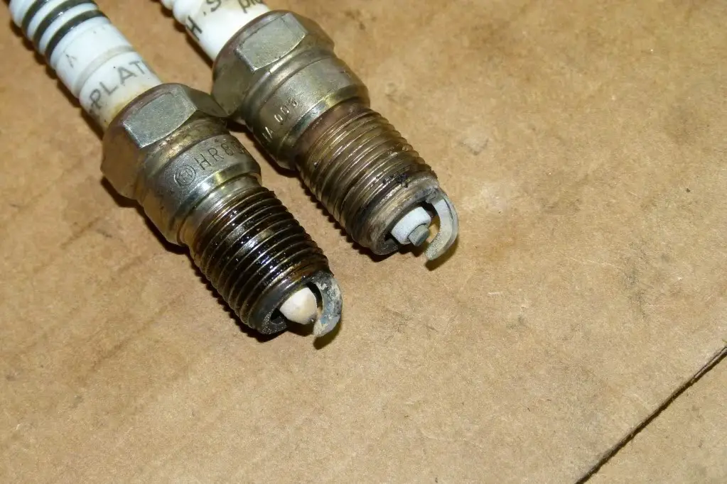

Here are a few pics of my plugs. What do you think?
I'm here to tell ya listen to JD on not driving it unless you want to put a motor in it.

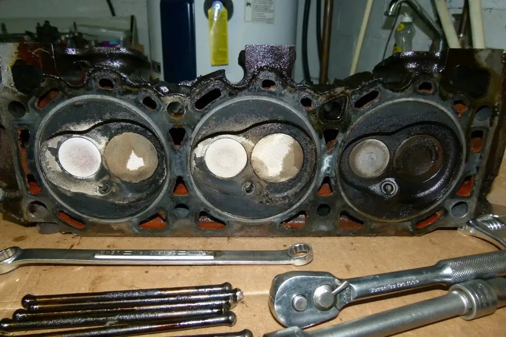

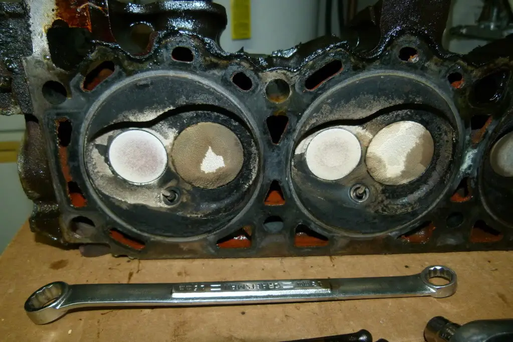

Well I finally got around to taking my heads off and here's what the passenger side looks like. You can see a few of the water jacket ports are almost totally pluged up.
Wow looks like a radiator flush is LONG OVERDUE

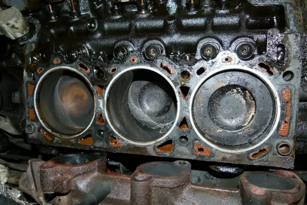

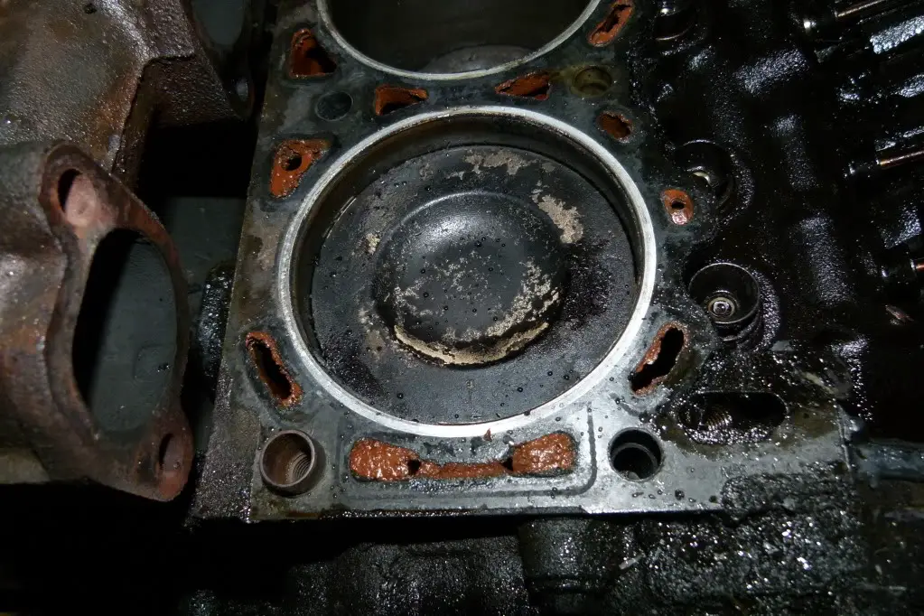

And you can see where the gasket blew out at.
Ya it's been over a year since I did a flush. I did it when I replaced my radiator.
Were do you see the gasket blown out?
