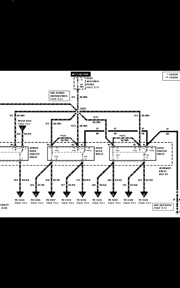

My diagram also shows aux relay box #2 for the door lock relay.
Anyone know where that aux relay box #2 is? I checked what I have and can't find its location.
Edit: lol, all the things I used to know but have forgotten. I posted the answer to that in '17, except the pic calls it box #4 instead of box #2:
