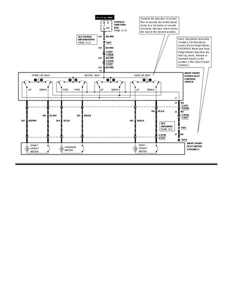

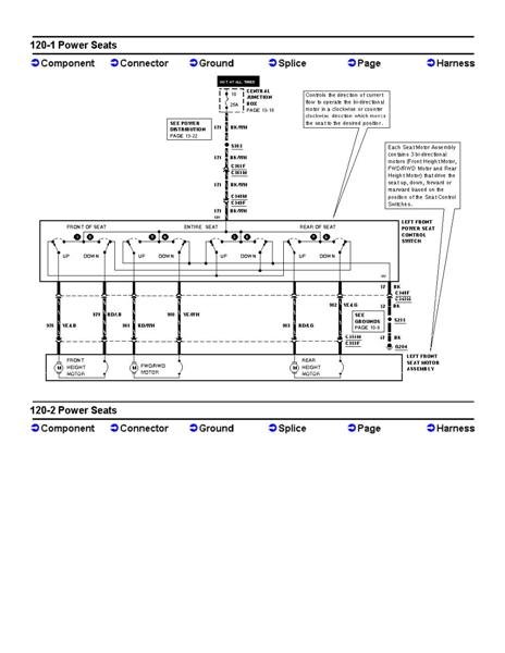

Need to see if anyone can tell me what the wiring diagram for power seats out of a 2001 explorer is I got the seats out of one and was gonna put them into mine just want to make sure I have the wiring right....there are only 4 wires...Im putting them into a truck that did not have power seats if that helps....
Thanks
schematics..
Sorry they aren't easily readable. Do you want me to email them to you?
2 wires should be 12V and ground, this will give you MOST of the functions
trace the wires back and figrue it out usually they are green with a ?yellow stripe? and black
