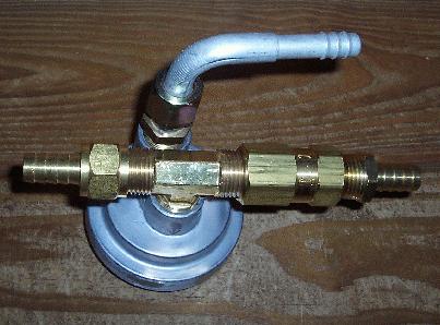

Few company's I have looked at but most are very similar. Biggest difference I see is that some have a piston inside the canister and some use a bladder. Clicky. They recommend installing them with a T fitting where the oil pressure sending unit is but after some reading I'm not sure this is the prime location.
So then I got the idea to install one of these. Clicky. It should allow me to hook the pre oiler between the oil filter and the motor. Wouldn't this be a better location as the oil filter should have a check valve in it so that when the pre oiler is activated it will only allow oil to flow into the motor.

sandwich adapter
The sandwich adapter is normally used when adding an oil cooler. At what pressure does the oil filter bypass relief valve open? I can't determine if the oil flows thru the filter before the external ports. Hopefully it does which prevents unfiltered oil from entering the Accusump cylinder. Also, it may be necessary to connect both ports and add a check valve to prevent pressurized oil from the cylinder from returning to the oil pan thru the stationary oil pump prior to engine start. I used a remote filter adapter instead of an oil cooler sandwich adapter.
Didn't go ahead and order the sandwich adapter. Couldn't decide what to do about it. If you order one just made for add on oil sender/temp ports they only connect in before the filter. If you get the type made for oil coolers you can't just block one side as ALL oil flow is directed out one port and into the other.

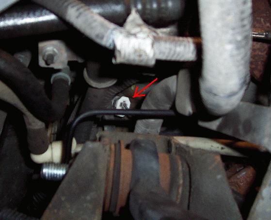

external oil port
The only external oil port I'm aware of is the one for the oil pressure switch.
It is located on the driver side behind the power steering pump in an area with difficult access.

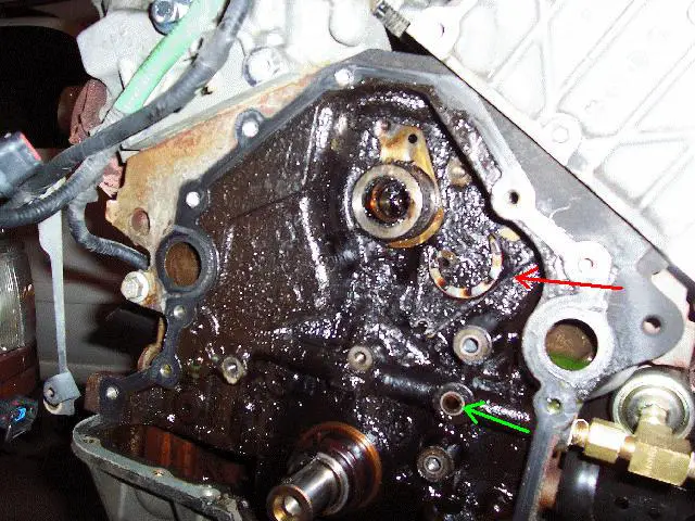

I installed a "Street Tee" fitting there for an oil pressure sending unit.
Another disadvantage of using that port is that it is near the end of the oil path in the block.
If the Accusump is connected there the oil pressure gauge will immediately register even if the oil has not yet traveled to the cassette hydraulic tensioners. The best location for the Accusump connection is at the oil filter. The Accusump installation manual has a brief discussion of one configuration using a sandwich adapter but does not show a diagram. I suggest questioning them about the filter flow and the use of a check valve. I purchased a Moroso check valve from Summit Racing.
After reading over your previous posts I have to agree with you that the best point is going to be at the oil filter. In light of that I ordered a sandwich style oil adaptor and a moroso check valve.
I plan on connecting in the check valve on the output of the sandwich adapter, then the accusump unit before running the oil flow back into the sandwich adapter. The down side being this will be unfiltered oil. I run full synthetic amsoil and even after several thousand miles the oil still looks very clean so hopefully this will not cause any issues.
Derale D25770?
Did you order the Derale D25770 linked in your original post? The description states: "Allows oil to bypass filter via a built-in relief valve when pressure is too high". I still can't decide if the external ports flow filtered oil.
I think you have selected the best configuration for a non-remote oil filter system.
