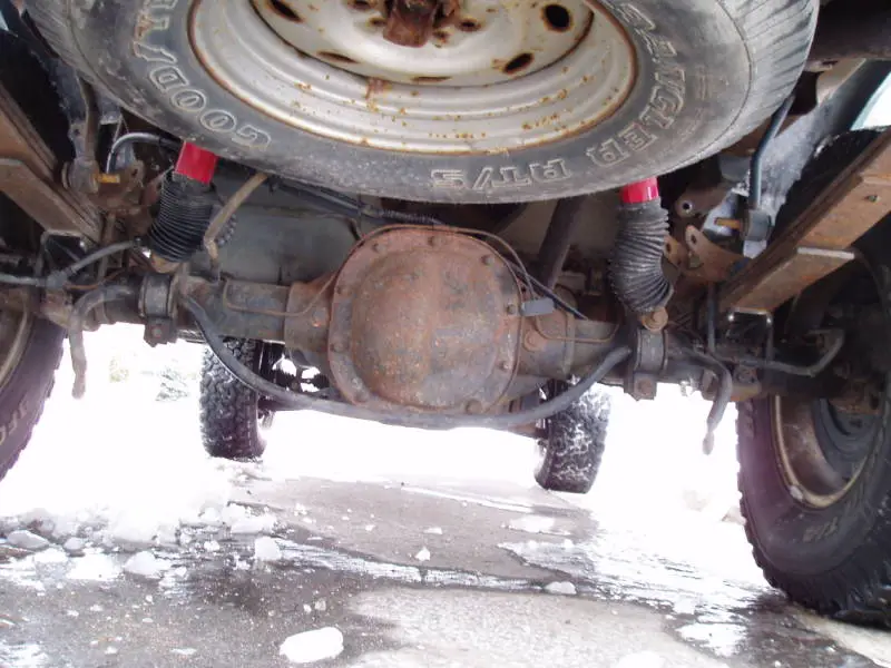

this ios what 2nd gens have. look under your truck and you'll see you have a different set up

so those brackets hanging out there above your springs? those arnt needed are they? not to offend you but it looks sloppy
His sway bar is disconnected for extra wheel travel offroad. They can be hooked back up for highway use. I believe that is what you were reffering to.
Nevermind... I took another look and saw that he relocated his shocks to his sway bar mount and the bracket above the axle is the old shock mount...

that isnt my truck. i just got it for visual porposes, but yes i do have a lift on my truck. YOu can go 3 ways.
Then to buy warrior shackles...70 bucks. This will give you about 4 inches of lift.
3) do an SOA...this is probably the most technicla as you have to cut the exhisting perches on the bottom of the axle and weld new ones on top of the axle. Then you relocate your shockson your sway bar mounts, like in the picture. Problem however with this setup is that if you are hard on the truck (acceleration) you get axle wrap and wheel hop...that breaks parts. So what you can do is extend the perches to be longer.
