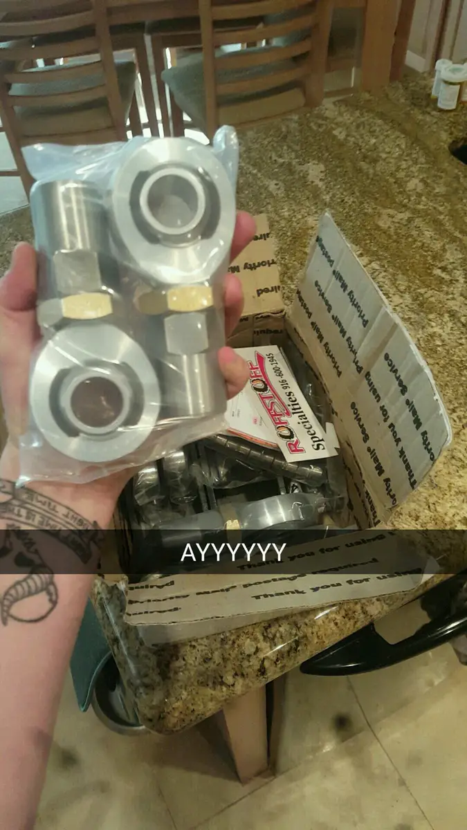

Scrapped the 3 link plan, going with radius arms and 18 inch coilovers. 1 1/4 ruffstuff heims frame end, 2" DOM links and ruffstuff bushings axle end. 7/8" heims and bushings for the y links.

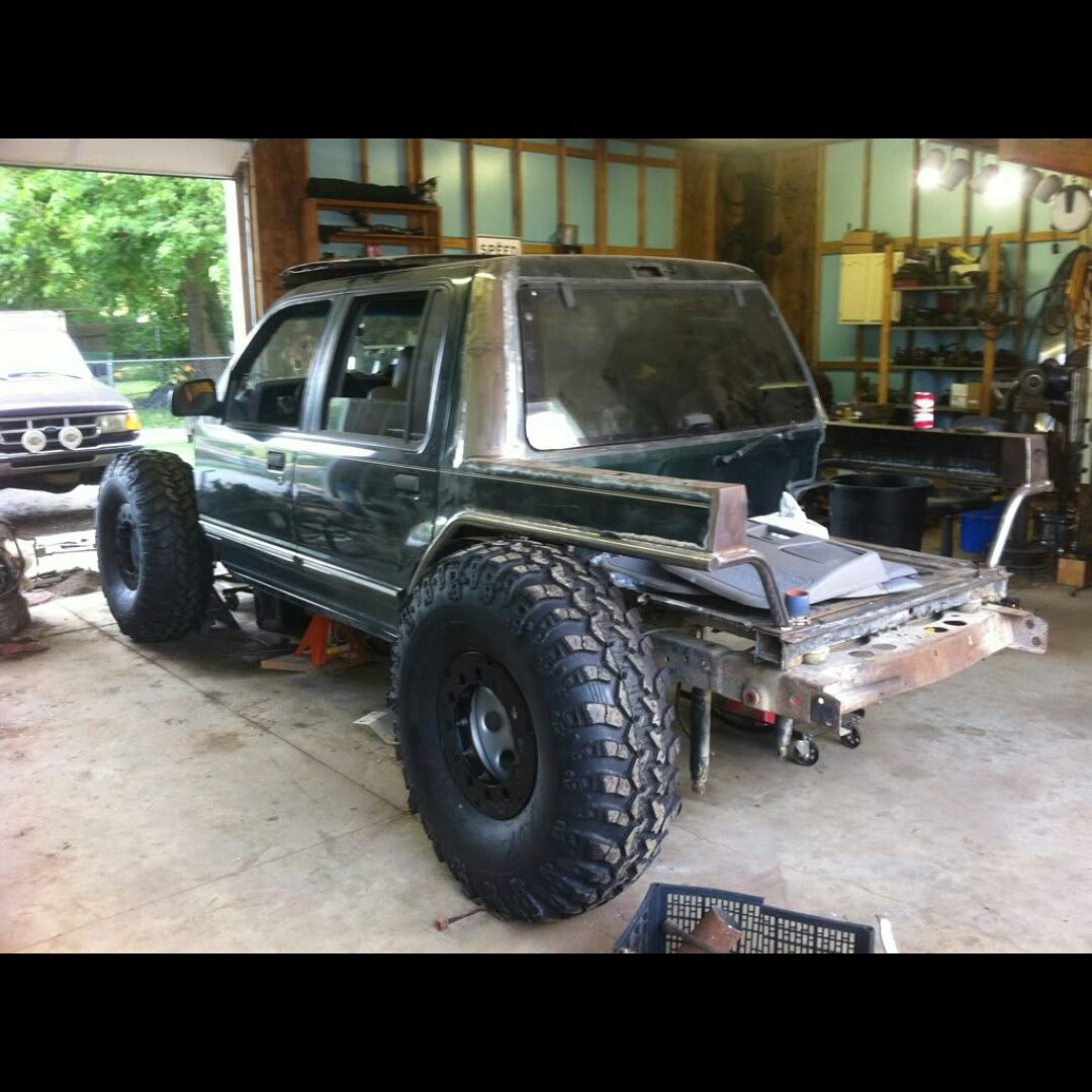

Basically the inspiration for the build. If anyone has some good reading on the steering box and radius arm geometry they'd like to link, I'd greatly appreciate it.

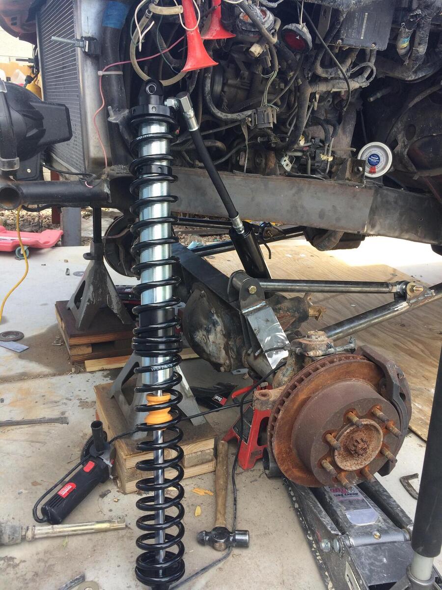

18" coil overs are real long. When I did my SAS, I spent a lot of time looking at shock lengths of other peoples builds. Most go with 14" max to keep them under the hood. If you go longer, you will either have a very tall truck, no compression, or you will need to go through the hood. There are also mechanical limits with straight axles; steering, drag link, etc.

Yeah the coilovers are going to stick up out of the hood, sheet metal really isn't my thing anyways. I plan to strap it before anything starts to bind in the steering and I'll just run it like that until I build a ford 60 with hydro steering.

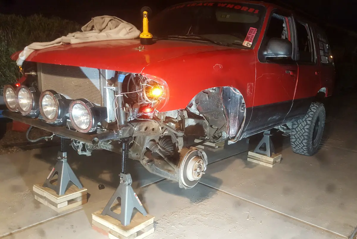

Got her up on jack stands. Took 2 days to clean up the shop before I started. Like my custom jack stand-stands? :hammer:

The fact that half the stuff wasn't there already made taking most of the front suspension out easy.

Drove down to FOA the other day to grab some coilovers and got all the mounts for them burned in, the front end will be sitting on its own weight here pretty soon.
