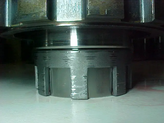

Here's a side view of the 5R's speed sensor "castle"/parking gear (notice that there is obviously some scratches in the steel from a collision with...the case):
Notice that there is SEVERE scarring of this bore where the "castle" has hit/rubbed/scarred/worn this bore. I don't know why, but the evidence is there that it did.
Perhaps from putting it into park while moving? I know I did that far too often because of the Atlas T-case. Think that'd be enough to shove it ****-eyed and contact the case?
Yep, I think that makes sense Jefe. Thanks for the reason for the scarring. :thumbsup:
