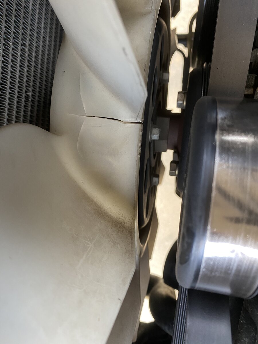

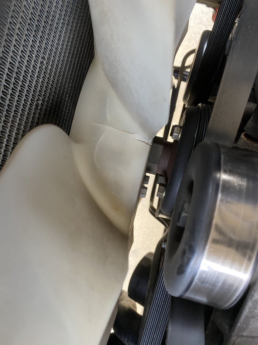

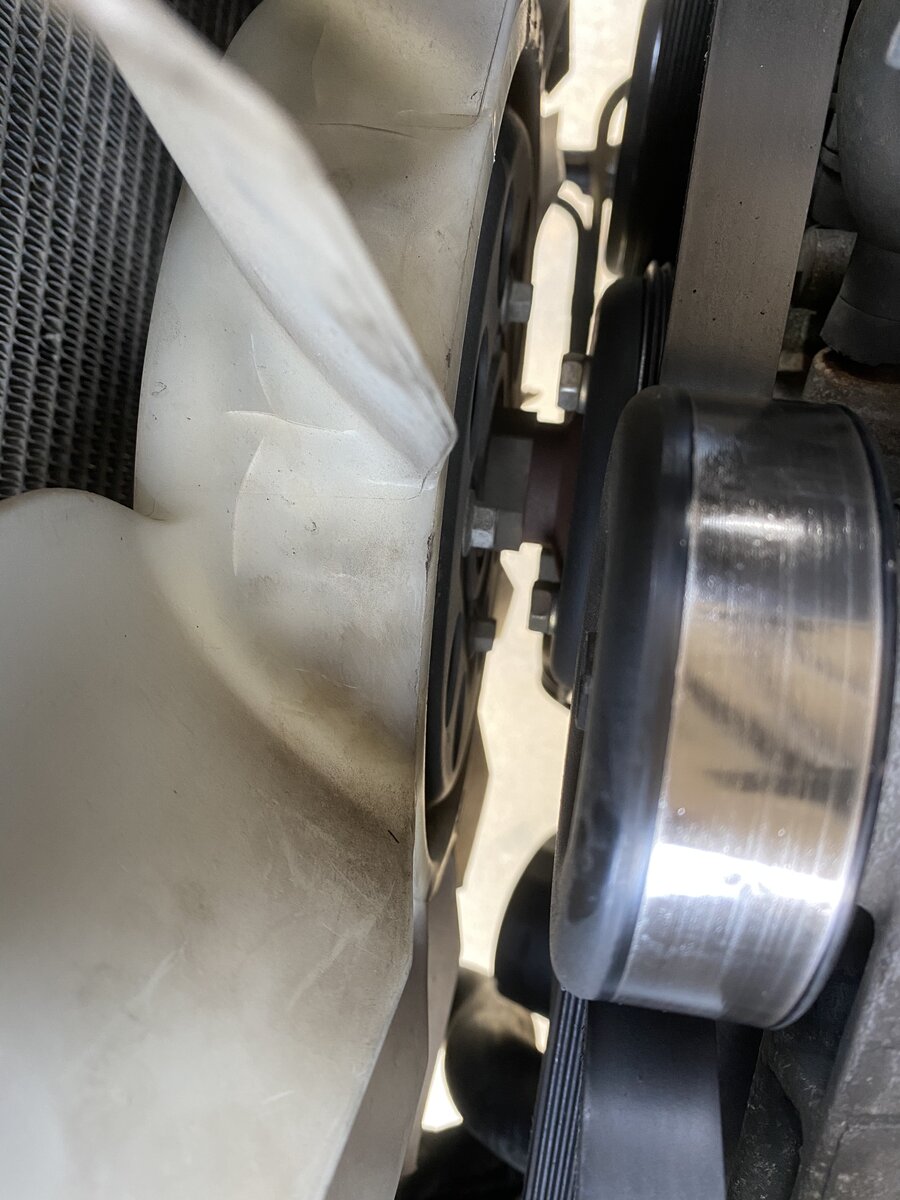

How concerned should I be about the condition of my fan? Some pretty big cracks.. i read this is common and supposedly can run that way long time? 😕
You should replace that if you can when you have time to do it. It's not a huge priority, but the fans usually take years to develop that many cracks. So it's on borrowed time now, it might last years more, or lose a blade next week.
Sorry to ask without looking but will eventually. Can I replace it without taking the front end apart?
Yes, getting the wrenches to rent, and loosening the fan(big nut) from the water pump is the only real hard part. There's not much room there, but you are only removing the belt, shroud, and fan assembly.

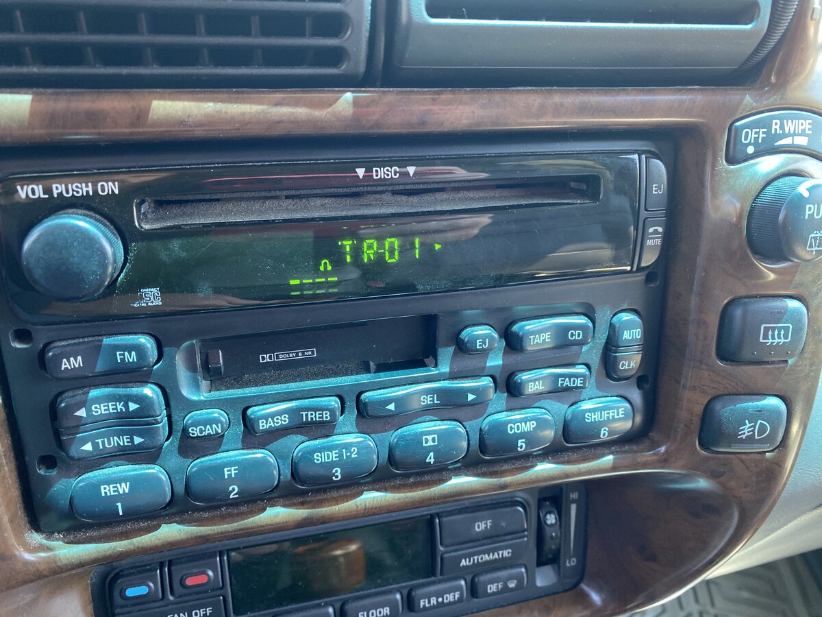

I saw junk yard near by me had a clean 2001 5.0 pictures showed the disc player in the console was what I was mainly after but I check for all kinds of stuff. Saw 3 different 5.0 with the changer but all destroyed and no cartridges. However one of them had an original head unit! And mine has not had a working display since buying it in 2009. And this sucker worked! I like the stock look and was pretty happy about that pick. 32$ I bought insurance on it just incase could have been 26$.

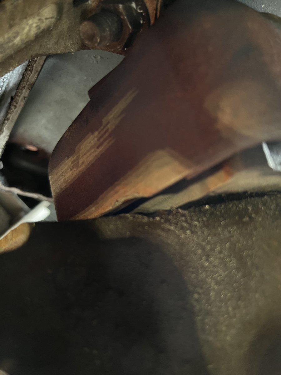

Yea my engine jumps around when gets gas. Otherwise it looks fine at idle, but the whole truck rattles. One of my engine mounts had Ben touching metal to metal so long it’s like 1/4 in of metal cutting into the frame mount. I’ll make a video tomorrow and take some pictures would love your advice on if it’s not engine mounts.
The click I hear happens when the engine is rough idle if or sometimes from acceleration at idle can make it happen consistently. I’ve been getting terrible gas mileage since the code has thrown. But the truck has always kinda “shaked” like an old dog or something.. lol. So I have been slowly chasing that. The suspension upgrades helped. The body mounts don’t look blown. Engine mount was my last spot before some serious engine issues.
that motor mount is toast!!!!!! HILARIOUS video
I mean sucks the mount is bad, but that is BAD BAD
You can swap the mount out it is not a terrible job and the parts are cheap enough
Did you solve the code?

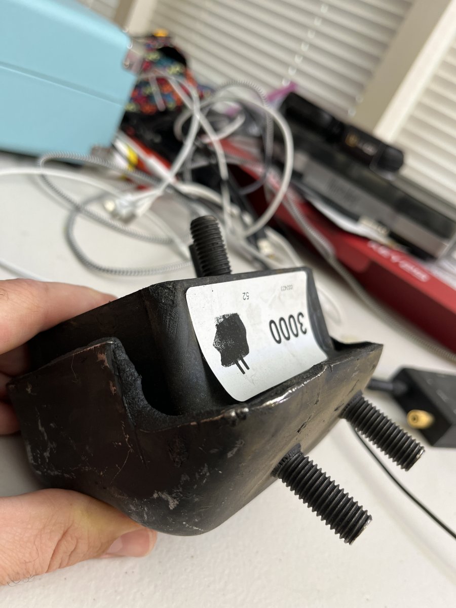

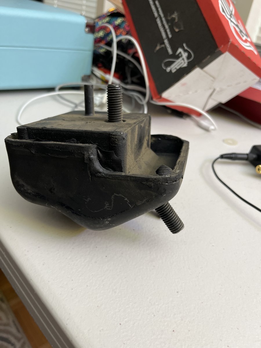

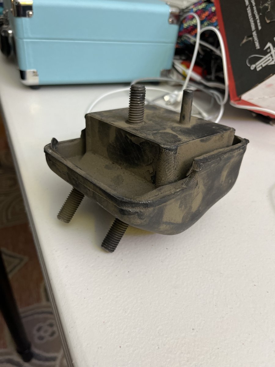

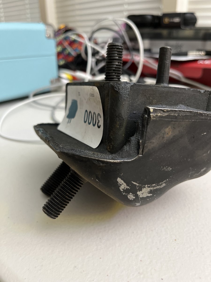

Still have code. And I have motor mounts. They have been toast for over a year maybe 2-3. But the mounts I received looked used or sent back.
Would you install these?
interesting
I see the anchor box in the background but why is the paint scratched and the parts dirty?
They are probably fine, going to be better then what you have in there
As far as I know you cannot get OEM mounts anymore so options are
return and get another set
fab something up
or run em
interesting
fab something up
or run em
Imma run em. Lol. I figure the rubber is the fine. And yea one was wrapped in plastic and the other was not. And the one not wrapped in as missing the part sticker like the other. Rockauto won’t pay return shipping on these for some reason, so almost same price to return them sadly.

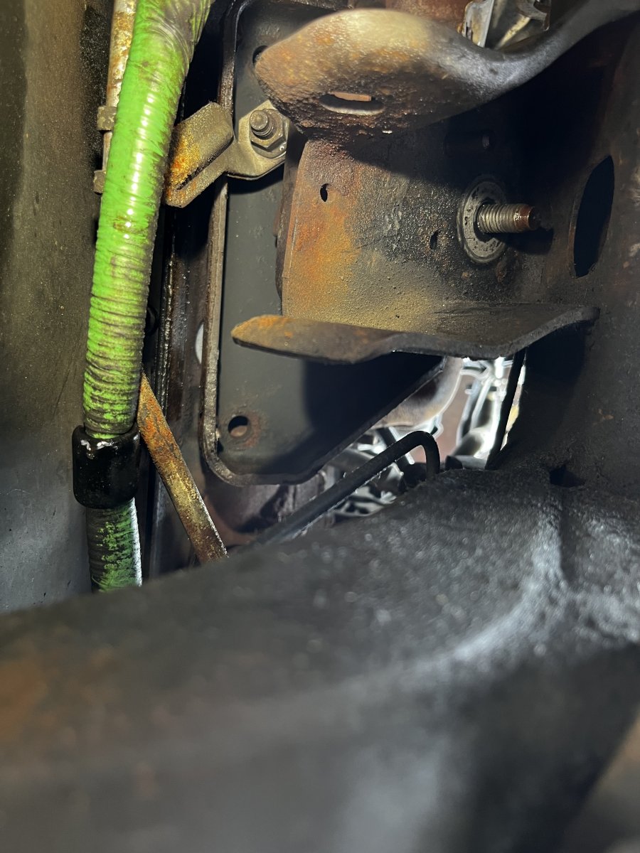

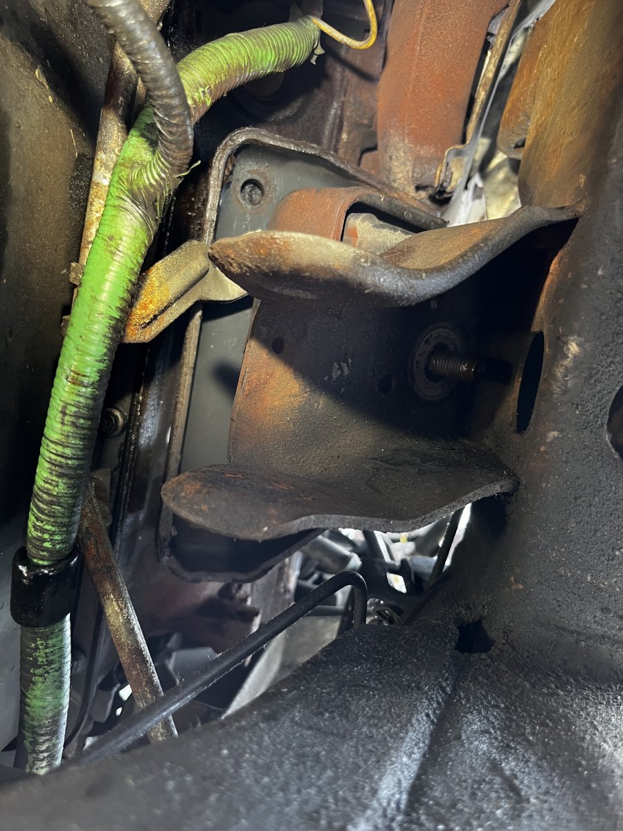

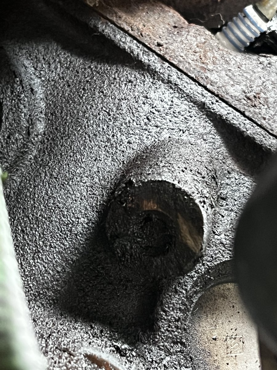

SOS :( so started doing the motor mounts. Found out why it was so bad. The plate that holds the mount to the engine, the 2 bolts that hold it to the engine were sheared off. I also have no idea even if these were not sheared how to get that Mount out of there ? To me it would take pulling the engine.. or can I put a jack under the transmission and lift there ? I don’t want to use my oil pan.

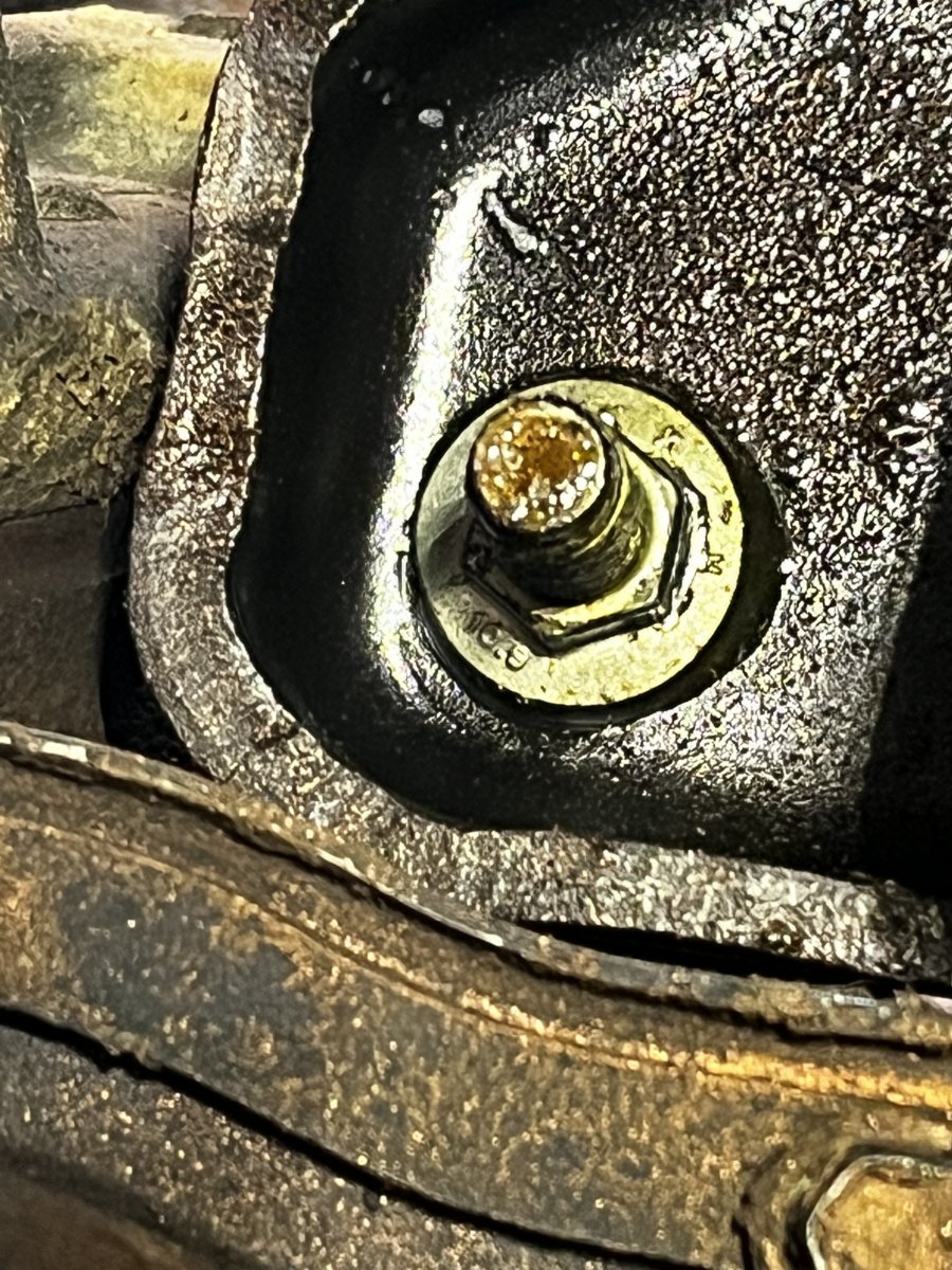

This is the bolts I need once I get the old ones out. Can anyone point me in the right direction on these ?
Better pic of the sheared bolts
So is it a bad idea to just use Self tapping metal screws to put that engine mount plate back to the engine block? I really dont want to try tapping clean holes from underneath.. And am wanting to get self tappers and just send them with the 250lb Torque gun...
I'm worried about doing that in cast iron. I'd expect it to crack
I have tried the reverse thread tap technique and its not going to work. What is my next best option? I'm trying to figure out how to get the old both threads out with screwing the threads.. but I am thinking of getting a self tap that will mostly just grab the Aluminum ( I think? ) Bolt metal and not stress the actual engine block much? Or this might be one I finally go to a mechanic for the first time in like 5 years : /
Edit: These type of bolts are my plan, triangle tipped tap bolts.. Thinking of doing the same thread size as the original hole? or one size down hoping the existing bolt will fill the voids?
