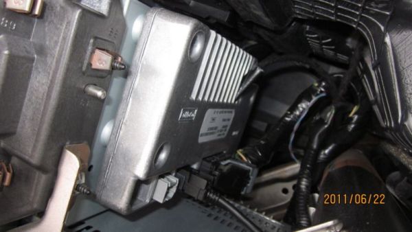

When you refer to the APIM you are talking about this unit located under the dash, right? I wasn't aware it was that crucial to the radio system. If it is, then you may be correct.
Peter
The apim is mounted directly to the touch screen
