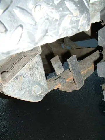

Take a look at Gerald's truck. He built some U shaped brackets that allow flex, but keep the springs aligned. My sammy has the same thing stock. I believe Gerald tack welded the brackets to his springs.
Here's a shot of the ones on my Sammy. Maybe it'll give ya an idea....

Originally posted by CodePoet
.... I would think that the leaves would remain in about the same position since the U-bolts, wouldn't allow them to get out of position too much. And if they did get out of allignment I guess you could always "tap" them back into a semi aligned positions with a sledge hammer......I just like hitting things with hammers though :)
They can actually get waaaayyyyy out of line. Once when we were out wheeling at Paragon, Lizardtrac's rear leaf moved out about 30°-45° from straight . We put it back in with a BFH and a ball joint puller (spread the other leaves to let it back in. We then wrapped it with wire to hold it in place.

If you replace them with a U bracket, there is no reason not to remove them. The problem is that if you don't notice a leaf is out of place, you could overstress the other leaves and possibly break one. I haven't seen that happen, but it is a possibility.

Take a look at Gerald's truck. He built some U shaped brackets that allow flex, but keep the springs aligned. My sammy has the same thing stock. I believe Gerald tack welded the brackets to his springs...
Yup, and Gerald got the idea from me :p
I put a full bead along mine, but I'm sure thats not great on the spring. I too had one of the leaves banging away at the gas tank skid plate until I did this mod.
any ideas where I would start looking to see if there are any adverse affects on the springs by welding on them, would simply removing the spring pack clamps, and replacing them with the "open-top" u clamps, improve flex in the rear on the stock springs. Also, Im going to be upgrading to a set of deavers, would the u clamps instead of the spring pack clamps improve travel at all on those...
If you weld them to the bottom leaf (thickest and shortest one in the pack), you shouldn't have any problems. That leaf is there to keep the rear from sagging under serious loads and doesn't really deflect much.
