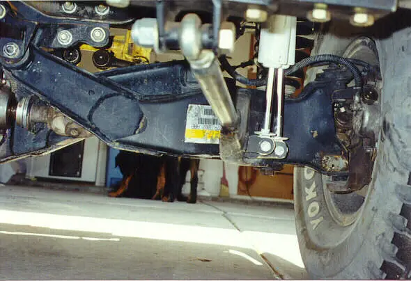

6. Rick, I'm going to take a shot on making my own radius arms after I make my prerunner bumper. How did you make the radius arm attach to the bracket..? It looks like a the top of a shock with shock bushings?

My radius arms have regular radius arm bushings. I would get their radius arms or build something like those with the heim joints instead of bushings. That's what Zimmerman did and look at their wheel travel!

I don't think I will buy their radius arms because they are $400, which is steep considering I should be able to build my own. I didn't think about using the heim joing because I thought it might be to complicated, but now that I think of it, it would be easier. Only problem is, where do you get a heim joint? Also, the picture of the Zimmermans Explorer doesn't show the bracket, I guess I should probably just emulate the stock one, except better.

Here is the photo of the Zimmerman's heim joint.
DON'T run a single tube for your extended radius arms like the picture shows. They bent theirs and I bent mine when it was like that. It needs to be reinforced like the one on CORE's page.

How quickly I forget you're going solid axle! Ha! As for the brackets, I did misunderstand but, I get it now. I definitely will do dual tube and I am thinking I will run 1.5". It shouldn't be to tough. I still don't know where to buy Heim joints though.
