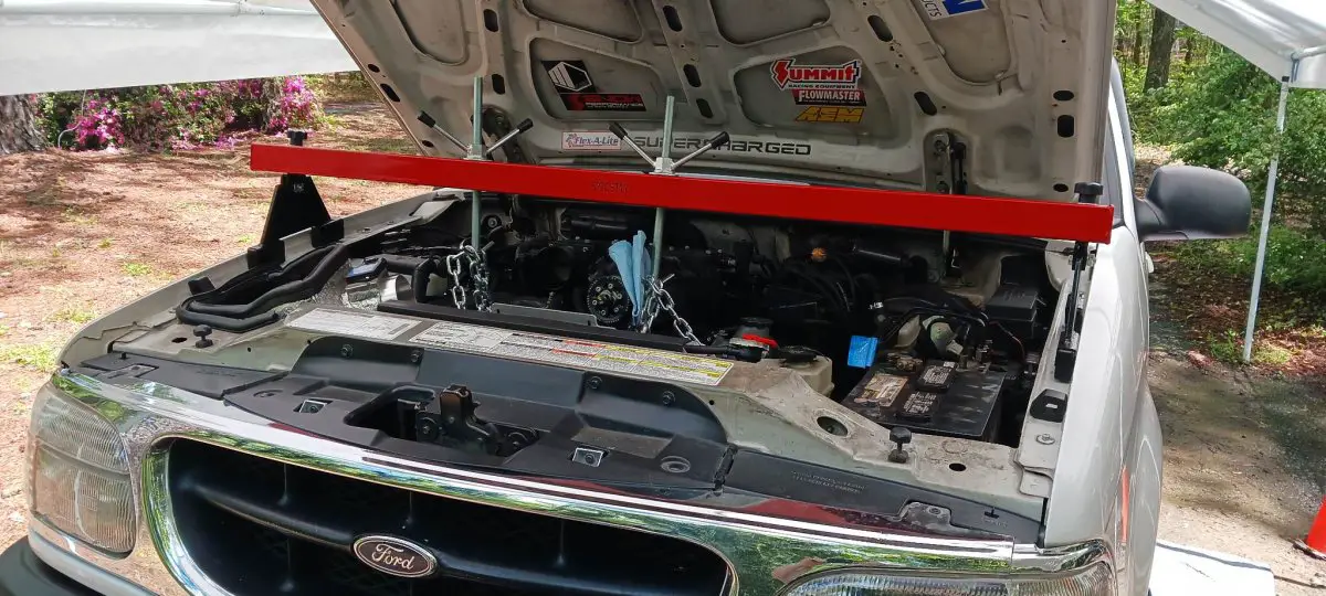

Use one of these to remove the rack works great
It's called a transverse engine Support bar
You only need to lift the w fine a little if it’s the 5.0
With your sohc engine you can change the steering rack without touching the engine

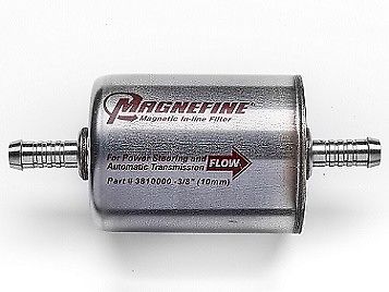

To ensure long P/S Rack & P/S Pump life, run a GENUINE 3/8" Magnefine (brand) Filter on the return line from the Factory Cooler back to the P/S Pump.
Available on Amazon = $22 for the filter & $5 Shipping
Carry on -
