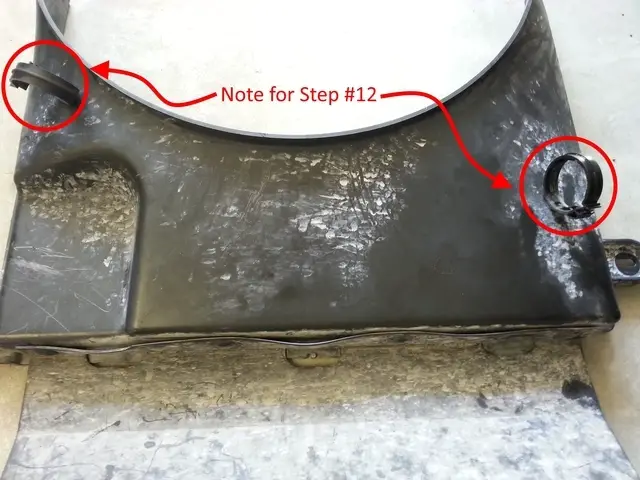

For Step #12: on the lower shroud there are two plastic circular hose ties ... unclamp the hose ties for the lower degas bottle hose and the hose for the power steering cooler (see pic below).
