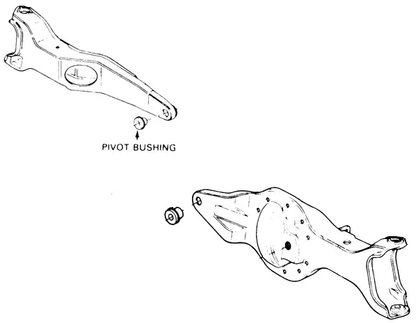

My Radius Arm bushings are shot all to hell. No matter what way you go about it the job looks as though it is a *****. Plus my RA brackets have lost the factory protective coating and have some surface rust on them now. If I am going to do this job I'm doing all of it at once. Factory parts lasted 20 plus years. I wanna upgrade. I do not want to lift the X. Keep in mind this is all theroy as I have not had any of this apart before and Im going off of just looking at my X up on the lift and the pictures in diggity0169's write up.
How to: Ford Explorer - Ranger Radius Arm Bushing Repair

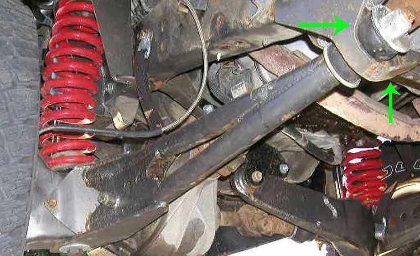

So I am thinking of doing a mod to my radius arm and radius arm bracket. I want to get rid of the "Radius Arm" type set up. Green arrows Pictures are not from any Ford Explorer.

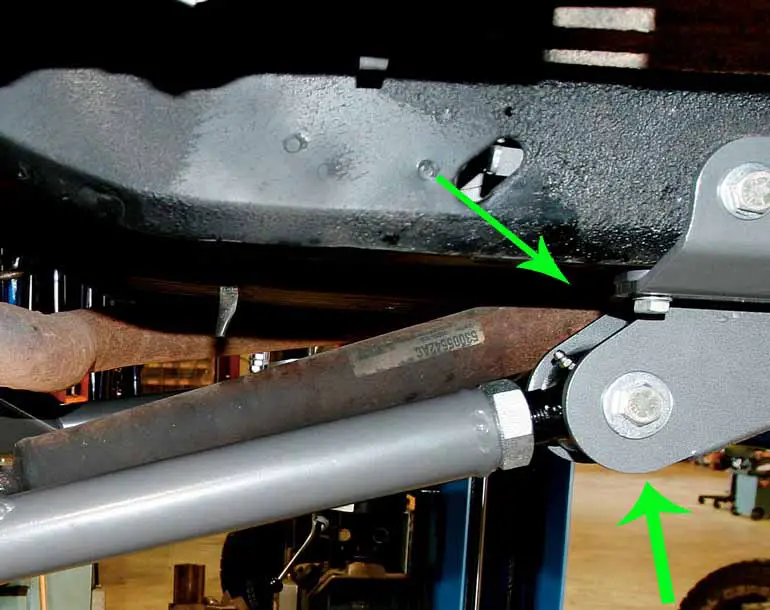

I want to do a control arm set up. Like this kinda: Green arrows once again.

From what I have gathered, this mod would not be a good one for a stock length RA. First, for the amount of work involved compared to replacing the bushing with a new one seems excessive and second, the limited benefit the mod would serve on a stock length RA.
The pic you posted shows a custom RA and it looks to be lifted. Is this your rig?

Like [MENTION=117556]malohnes[/MENTION] said.. changing from the post style to a heim/johnny/ballistic joint probably won't work well on a non lifted rig.
First thing.. Look at where the post (RA) mounts are. You can see they are inboard of the frame. Pretty much every (if not every) time you see someone modify the end of the Radius arm they put it under the frame, including me. That alone can mess with the angles as you just pushed the pivot point to the outside. On top of that your RA may hit the frame not as the tries go up (depends on how much travel you have and the normal ride height). Also, it makes the Arms hit the tries quicker during turns.
If you want to go this route, the easiest way would be to cut the end of the arm off and weld in a tube with some reinforcement. Now you could put in whatever kind of joint you wanted. I'm using a Ballistic Joint but a Johnny Joint would work too BUT you will pick up vibration/road noise etc with a non rubber style joint. Now you need to make the mounts that will allow the suspension travel without hitting things.

These pics are not of my vehicles. The custom RA is a 79 Bronco I believe, and the custom lower control arm is of a TJ Wrangler.
