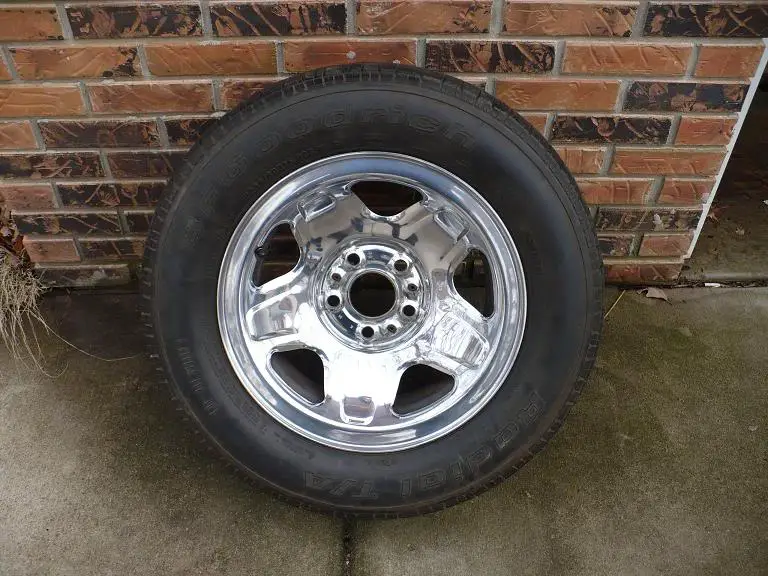

i have a set of 5 spoke ranger splash chrome rims i was planning on using. they have 235/60-15 tires on them. i hope these will fit bc i like the way lowered trucks look with stock rims and lower profile tires.
here's one of them
so which ever axle i use i'm still going to have to have the plates re welded. i guess i should wait till i get the truck and take some measurements to see if i'll be able to fit an explorer axle. anybody have info for swapping axles? links would be great.
