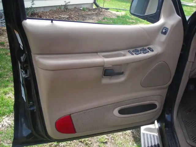

Ok, here are the pictures of the door panel removal. I'm sorry the quality wasn't the greatest, I did this mid day and had A LOT going on today and didn't realize my camera was on the wrong setting until it was pretty much too late. I'll try to take better ones tomorrow when I remove the passenger side.

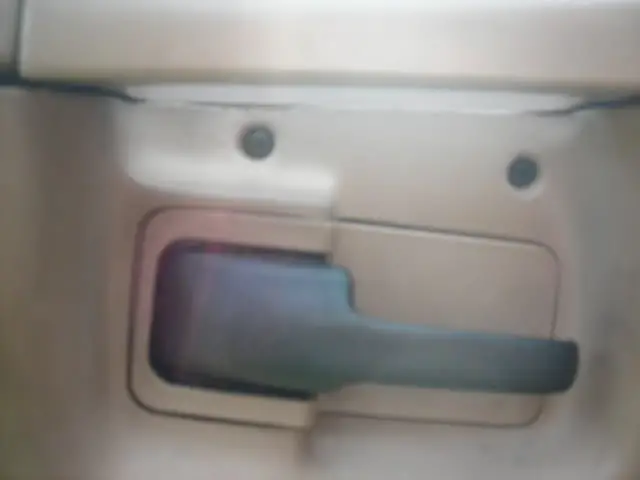

Here is what I started out with

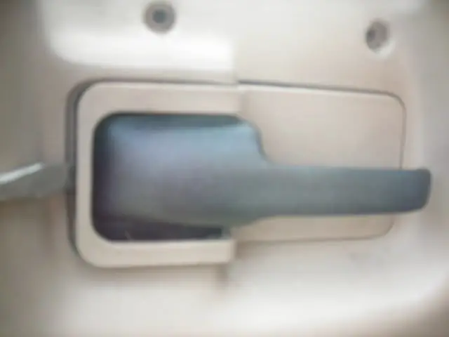

Here are the ONLY 2 screws holding the door panel on, they are a regular phillips head style screw, remove these first.
Next use a fairly thin blade flat screw driver and starting where pictured, easily pry the door handle surround out. I had to pry the back a little to pop it out and the top then I was able to gently remove it by hand

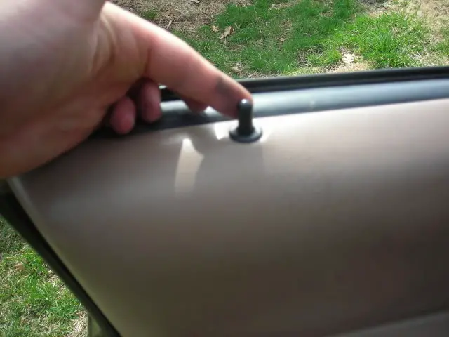

Next unscrew the plastic cap on the door lock

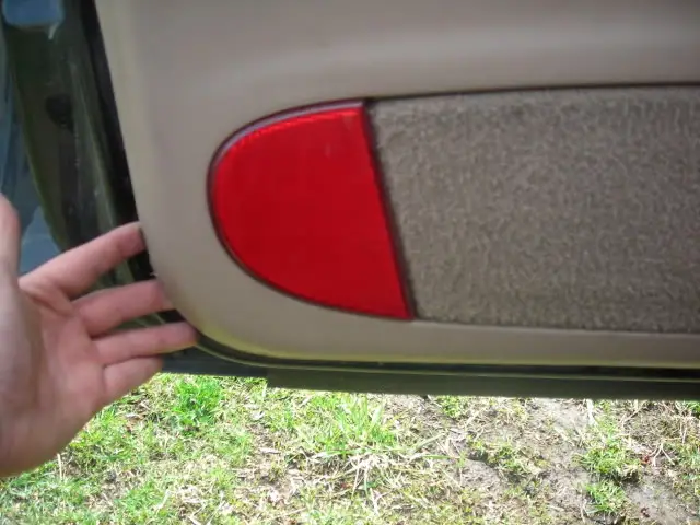

Next, starting at the lower rear of the panel, as pictured, easily grab the panel and try to slide your hand in behind it. You may hear a plastic popping sound, it is just the plastic clips holding the panel on coming loose.
Now move to the lower front of the door panel and repeat the last step
Slowly work your way up both the sides of the door panel equally. Each time you slide your hand in you should hear another pop as the door panel comes loose.

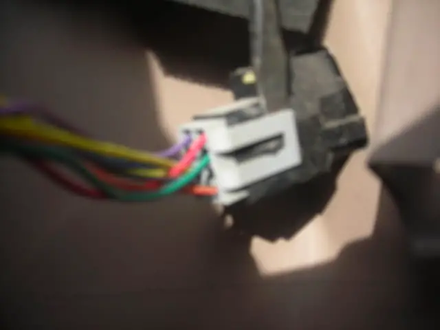

My Explorer has power mirrors, the plug is easy to remove, slide something in it as pictured and slide it off or just easily pull it off.

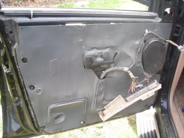

The Factory door pull handle and window switches just slide through the back of the panel and this is what you are left with

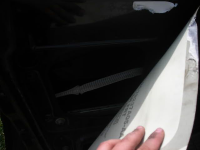

Start at the corner and carefully peel the insulation material back, don't damage it too much, if it tears you can tape it, no one sees it back there, mine came off intact, yours may not
Here was my problem, the rod for the door lock actuator(center) was bent and had fallen off. I tried to bend it back but I can't see it happening, I don't even really know how it happened.
