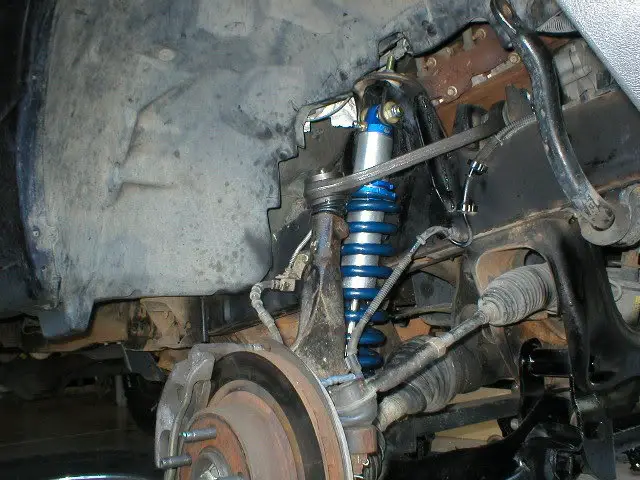

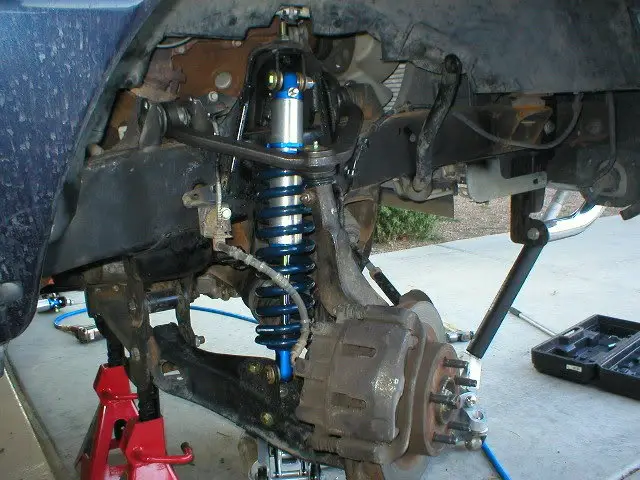

Its a ranger ;) and I have a superlift on the truck. And i removed the torsion bars and put these in. Cranked the coils so the front sits even with the rear! And i dont have pics yet of the truck. I will soon and i will post them.

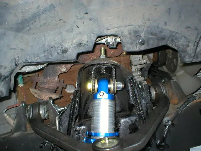

Looks good, what keeps the shock from sliding back and forth along the bolts though?
There is a spacer inbetween those washers i have shoved in there. Its the same size as the hole in the fox shock so it doesnt move back and forth!

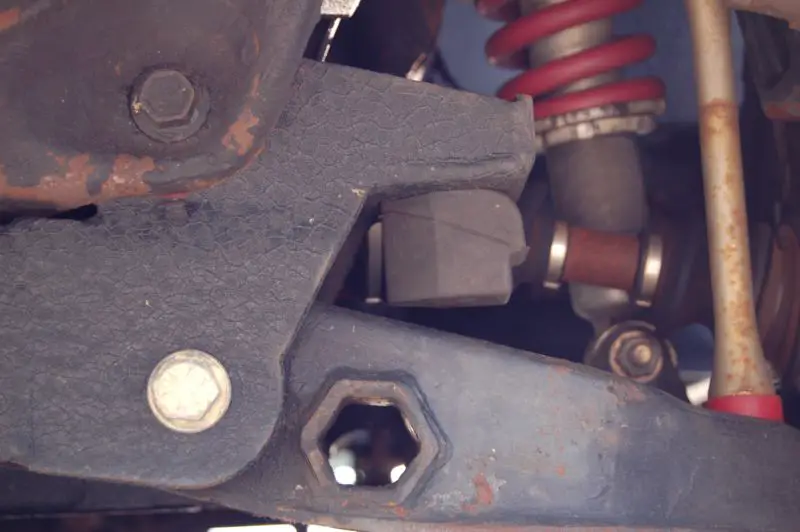

I took a pic of the drivers side Bumpstop, it seems like theres not enough gap,but I'm not sure about it ?
I've been trying to get the pic smaller to post it,but it's not working out too well. sure wish I could email it to someone to take a look at it ?

That gap does not look too bad, but the distance from the pivot point to the bump stop looks short. Is that the same as stock? With more leverage, closer to the pivot point, the bump stop will be crushed easier and be less effective.
could the bumpstop be trimmed ?,I have to say I know very little about this stuff ?,not even sure how thats mounted ?
I'm hoping someone with an RCD lift will chime in !!
the line in the rubber stop that angles up toward the pivot point ?, thats not a trim line is it ?, that wouldn't leave much rubber would it...
That looks like the OEM part, I think that the bolt head is right at the middle of that. I wouldn't trim it unless it was a last resort. It may be fine just like that, my worry would be for it to crush and wear out too fast.
