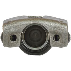

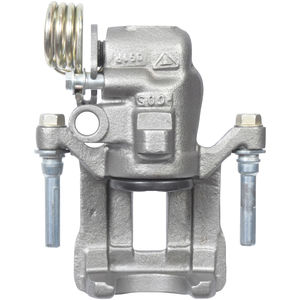

Explorer rear caliper:
http://contentinfo.autozone.com/znetcs/additional-prod-images/en/US/fen/C576/2/image/3/
Mustang rear caliper:
http://contentinfo.autozone.com/znetcs/additional-prod-images/en/US/fen/C394/2/image/3/
every car and truck I've ever owned (including my daughter's 2000 Mustang) had rear calipers whose pistons screwed in. I honestly have not had to replace rear pads on any of my Explorer'/Mountaineer's, but i'm pretty sure the pistons screw in. one way to tell is if the piston appears solid, rather than hollow, and has small indentations cast into it's face for the tool.
I've done the rears on my 06, and they push in.

The rear calipers that have screw type pistons don't have parking brake shoes.
There's a lever that the handbrake cable pulls on that rotates the piston to screw it in to clamp the disc.
