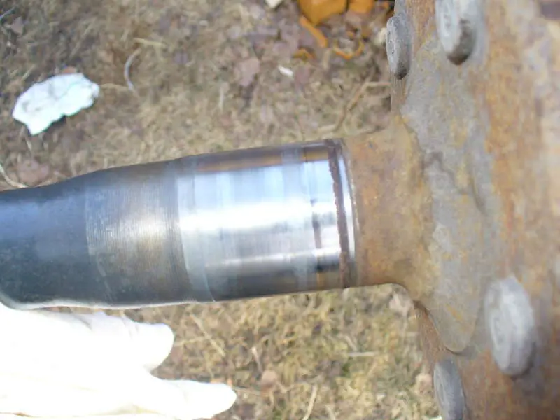

Anyways Gavin.. Ah, I see. What's the odds the axle shaft is damaged? Are they pretty tough or once they start.. that sucks..
It has gone from a light metallic scuff noise, to a ... well.. sounds like the bearing is wearing down nicely.
I was told these were bad enough to replace them.
those axle shafts had probably well over 170k miles.
the vehicle was also abused at times.
Although the grooves don't really look all that bad, that is just what I was told, and at the time I was able to afford a set of brand-new Yukon's off eBay for a very good deal.

it's possible the axle is perfect, it's possible it's a disaster.
as for sitting... part of that would depend on wether or not their is still lube in the diff. With lube, I'm sure it would be fine. Without lube, most likely fine, but more chances of rusted bearings.
as for cheaper... it depends on which bearing is going out on your truck.
disconnect rear driveshaft, jack up rear axle, rotate tires. Try to determine if the noise is coming from the outside of the axle tube (axle-shaft bearing), or the diff area (pinion bearing, carrier bearing).
If it's the axle-shaft bearing, it should be pretty damn cheap.
if it's a pinion or carrier bearing, it will definitely get spendier.

Definitely the outside bearing, I guess if it's truly gonna be cheaper for repair I gotta forget about 4.10 gears for now...
