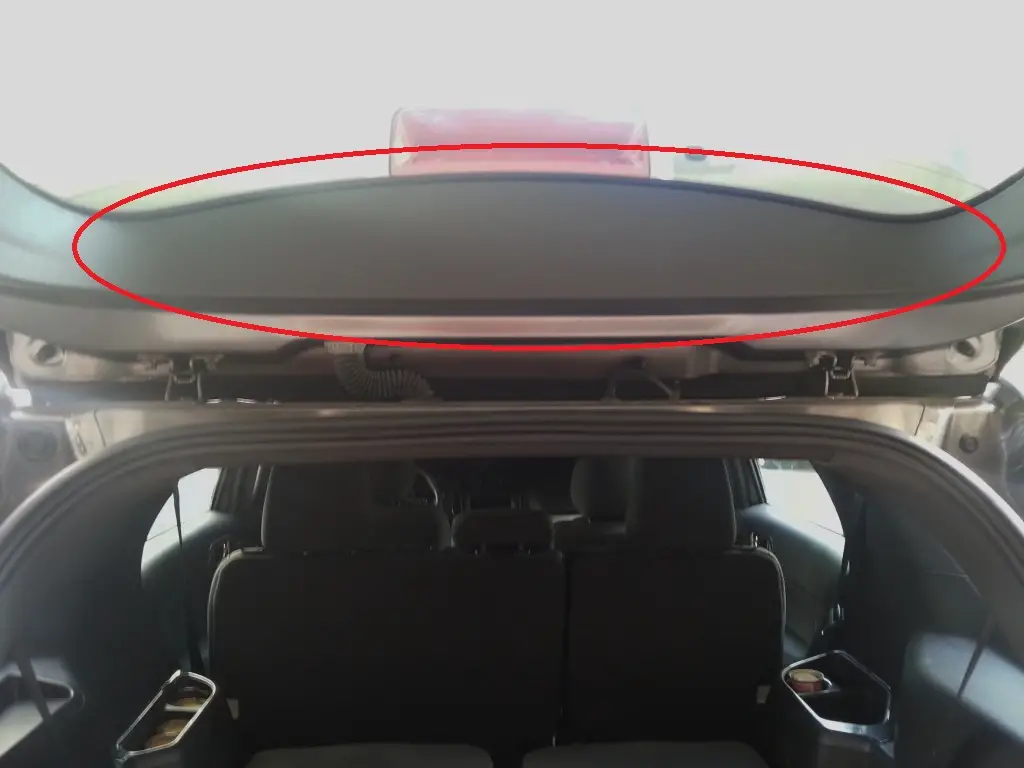

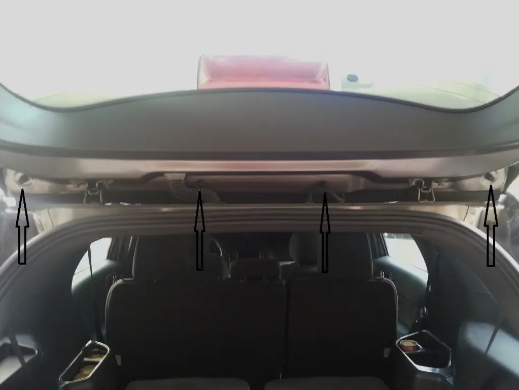

I removed the spoiler yesterday to fix something and put it back on without any issues. Please find some pictures below. Hopefully it will help you guys to get it removed without damaging something. Remove the plastic tail on the inside (with the clips) to get a hold of the 5 screw to remove the spoiler. There are some clips as well but with a little bit of pulling they flip out very easy.
Let me know if you have questions.
Thanks a lot! finally:)
and just to be sure I understood the 1st step. The liftgate moulding is this part, correct? coz it seems very hard to remove them.
if anyone here going to tackle this, could I request if you could take photos or a video demo would be awesome. Thanks thanks thanks:)
Start on one side and pull it out and make your way to the other side... it's very hard to pull it out but the clips and the plastic is very strong so you wont damage it.

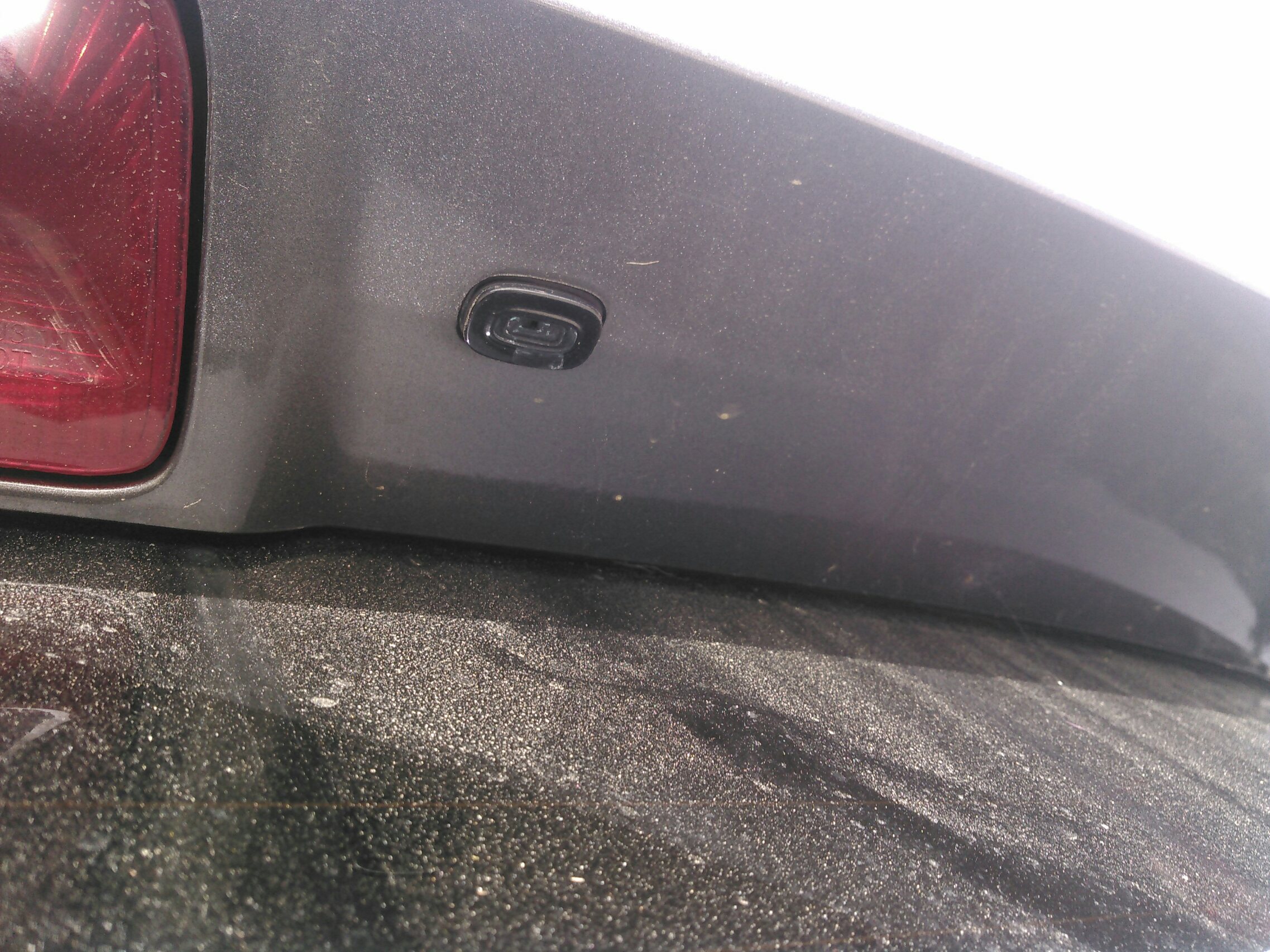

What is that little piece just to the passenger side of the brake light on the underside of the spoiler? Some sort of detector to tell if the gate is open?
That is your washer nozzle.:)
Peter
D'uh. Can you tell I'm a new owner? :)
If it makes you feel any better, someone else asked the same question before.;)

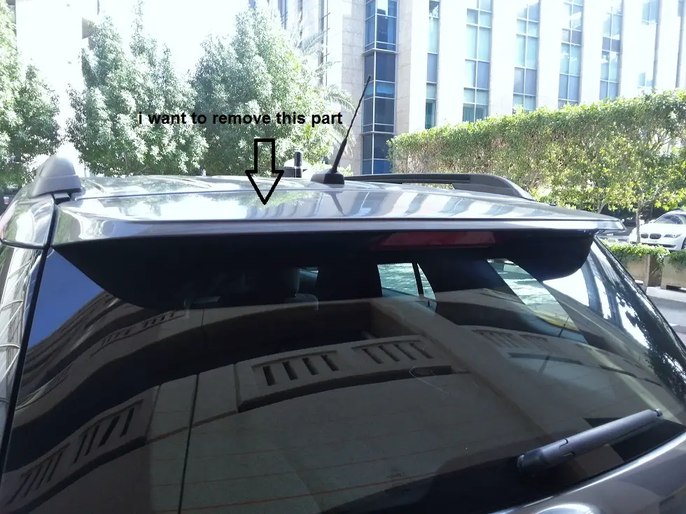

Hi All,
I am planning on painting my rear spoilers if that is what its called (haha) and since it would be a lot easier to do it if its removed from the car I would like to ask anyone who knows how to do this or has done it before and it would be great if you could teach me how.
I saw that there are 4 unusual looking screws on the back of the lift gate... Are These all I need to unscrew to remove the spoiler?
Here is what Im talking about.
Why don't you just vinyl wrap it? Forgive me if someone already suggested that.
