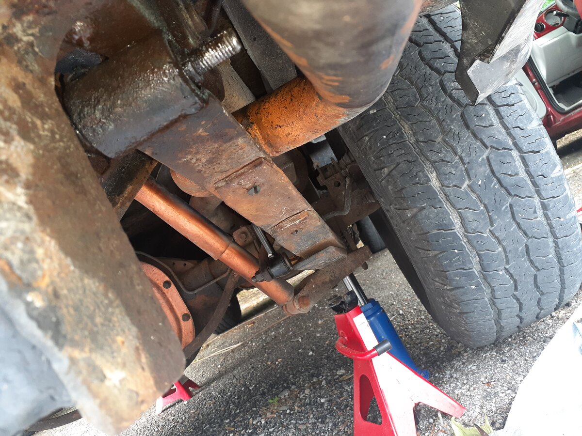

I used explorer springs on my 87 ranger, I torched the rubber out and used polyurethane bushings. If the shackles are removed on both springs, jacking the car up higher by the frame will allow the leaf spring to hang lower to gain more working room.
