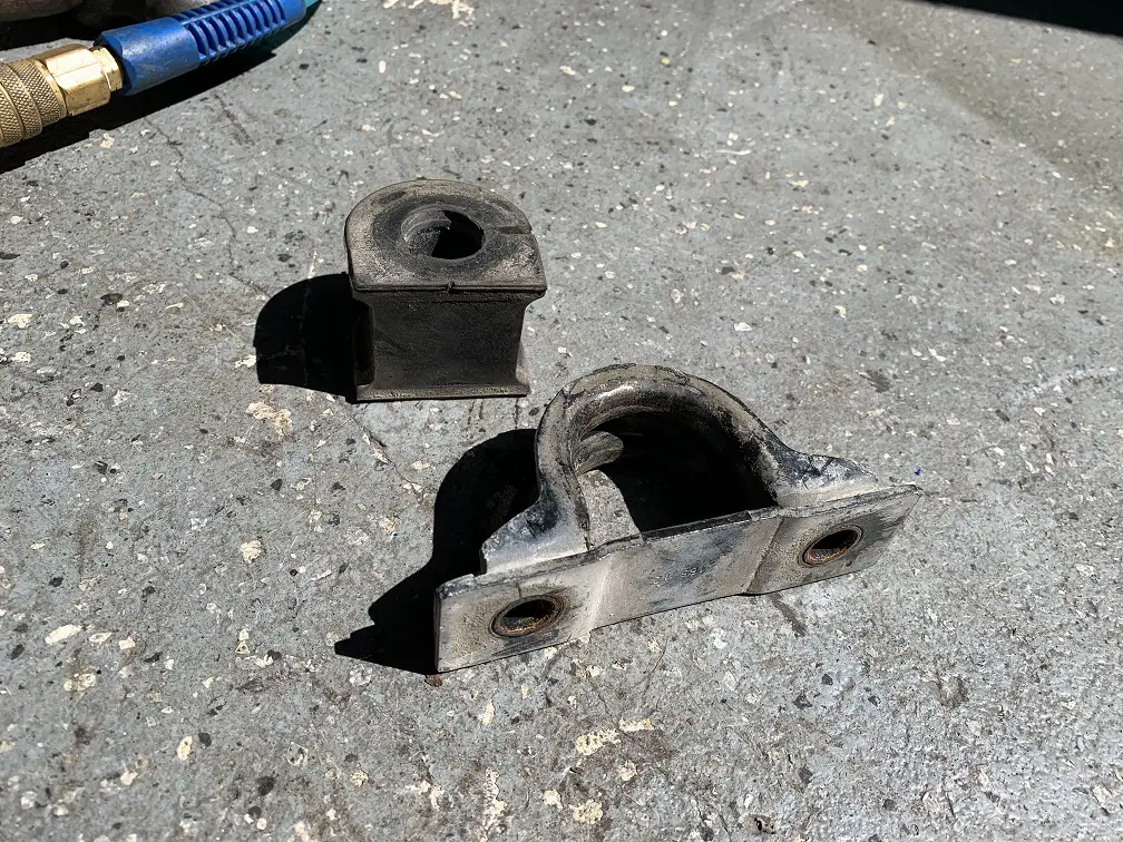

Does anyone know if rear stabilizer bar bushings are replaceable? Can't find those bushings anywhere and the bracket looks like it is all one piece, top and bottom. Mine separated from the rubber bushing and I can't get it on.

Just an update - for all that will have to deal with this - I was able to separate two pieces of the bushing bracket and then squeeze them back together once on the bushing and bar. All good.
i bought replacements that are split on amazon i believe. wrote it up in my thread. factory are drilled out and then replaced. worked well.
nope. is there a need for or best practice in doing so?
