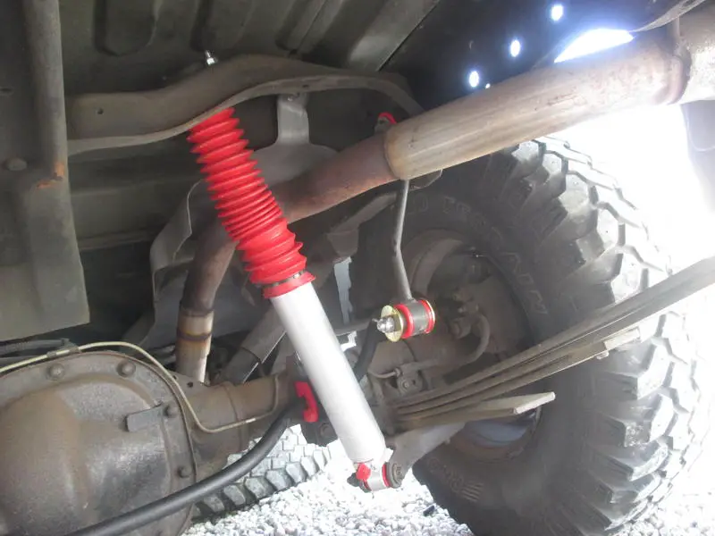

I previously removed the rear sway bar links and am looking to reinstall but I seem to have lost some of the hardware. Should there be a washer where the link bolts to the frame? If so, frame side or bolt head side? Also, any ideas on diameter and thickness?
just did a set today. i thought the washer wend on the bottom between the link and the bar!.
I did my set yesterday, i got the Energy Suspension set. I will double check tomorrow but this is how my set up was
Link to frame
Bolt - washer -link - frame
I just found some pictures, the link to frame mount pics aren't very good bu you can get an idea of size. The Energy kits came with 4 washers. I kept the stock washer on the link to frame and used the new washers on the link to sway bar. Hope this helps

Wonderful. Thanks for the quick reply all.

Energy Suspension 4.5153R 19mm Rear Sway Bar Set. It didn't come with any upper link hardware.

Right, I meant the brackets that secure the bar and large red bushings to the axle. I live in the salt belt in eastern canada, so mine are sufficiently rusted and will probably need replacing. I really wish the underside of my truck looked like yours!
Ah, gotcha. I miss salted roads, I moved to California too young to enjoy working on a rusty undercarriage. I'm sure you can pick them up at any junkyard. This coming weekend I am probably going to a Pick your Part (50% off sale) I can pick you up a set, just pay shipping and what I paid for them. Though shipping may suck. Check rates through USPS.com 92704 is my area code
