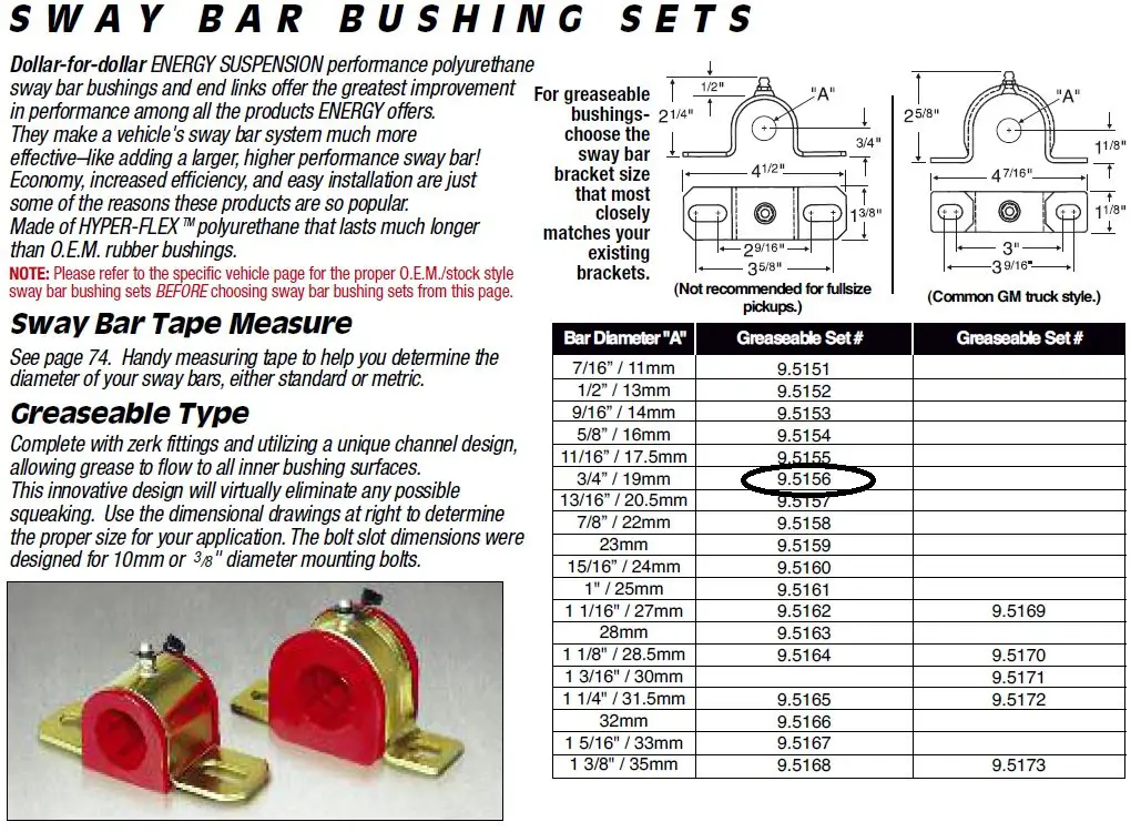

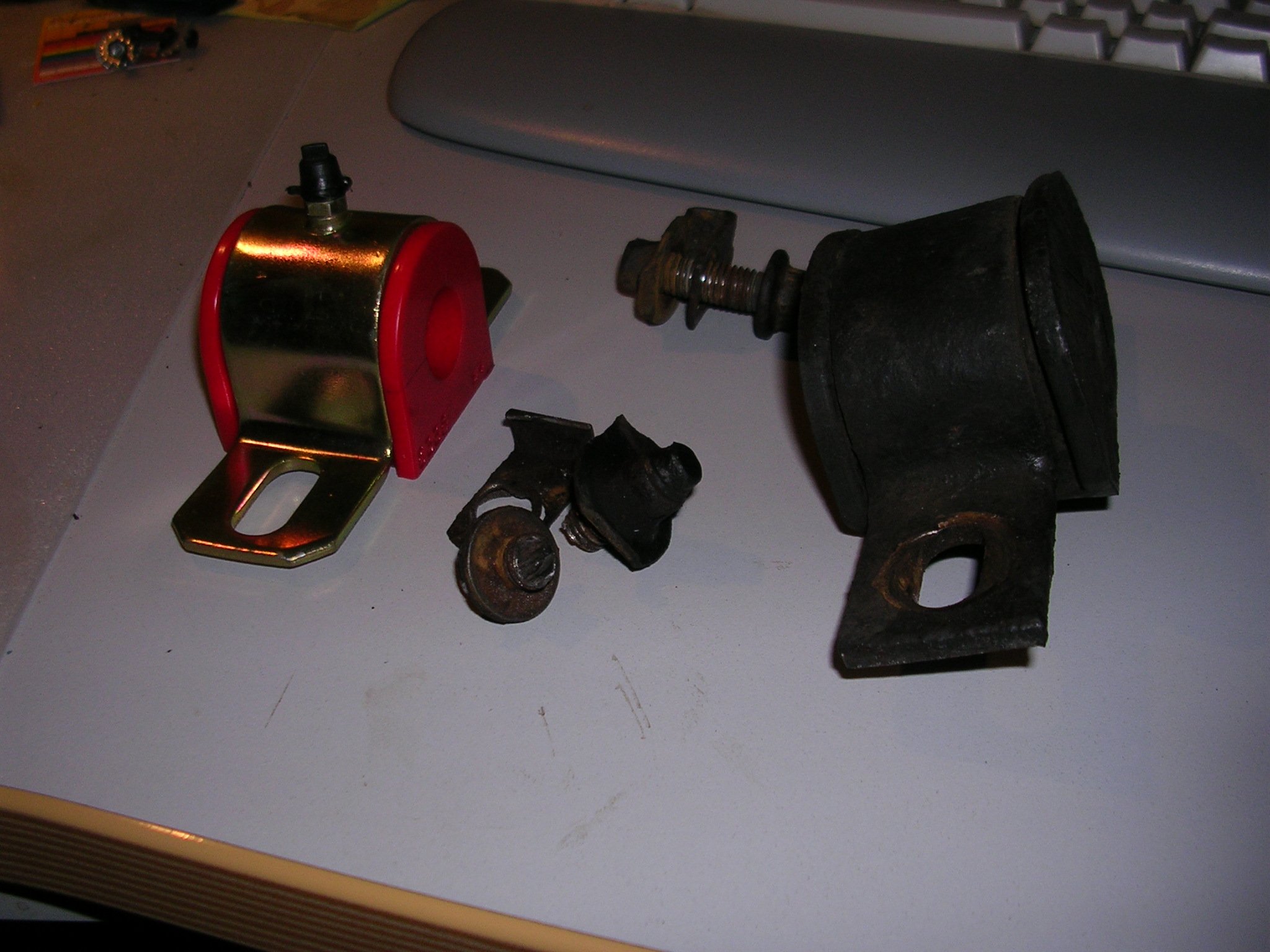

Our V6 has a 3/4" / 19mm rear sway bar, years ago i bought this part from energy suspension.
For a drop i would use shorter front links or shorten the old ones. Rear links did not have to be shorter.
The ones that I used

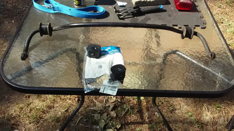

I would recommend running the shorter links from an F250 too keep your rear sway bar in a better position and prevent it from tipping down and towards your shocks. I used Moog K80268.
