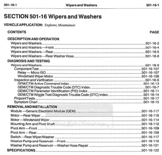

Mine too until it quit working altogether. I have a Ford manual on CD. The diagnostic tree is multi-factorial. (It's got 'game'.)
I've got suspension & brake repairs to do before I tackle the rear wiper.
If I can share screen shots of the diagnostics maybe someone else can guide us down Ford's 'yellow brick road'? I'm not an electrician...

I have beer money for you if you can burn me a copy of that cd
[...I created a .pdf file of 'just' the 'wipers' section (122 pp.): 297 MB! This derivative file is larger than the source file that is copyrighted!]
