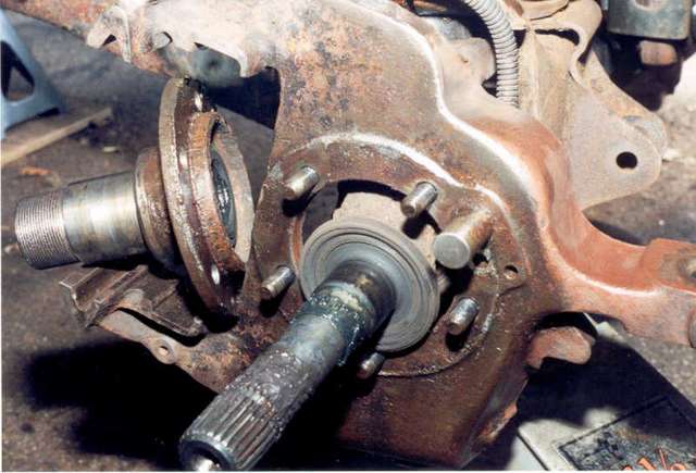

Here is a pic of a removed spindle. As you can see it is held in place by 5 nuts (but the actual weight of th car is on the spindle's lip which passes through the knuckle). A little trick to seat ball joints is to place them in the freezer a few hours before pressing them in place... The cold will shrink them a tiny bit allowing them to easily get pressed in... :thumbsup: BTW if you or your uncle run into any problems post back and we can help you through it...
