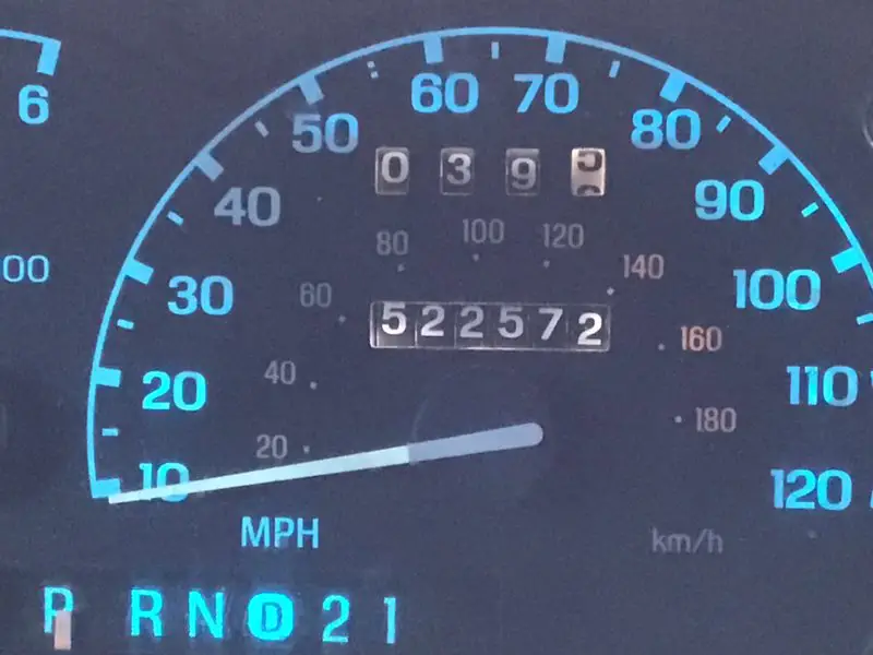

120 mph LMAO
The 97 still has the t case mounted VSS right? by those miles the drive gear is usually worn out!!
Yes... But CV axles are still original. I would replace them as maintenance, but am always concerned about (cheap) aftermarket parts.
I wouldn't worry much about the CV axles, considering you still have the rear to push you along if something weird happens and one fails suddenly. Then again if you intend to keep it *forever*, parts aren't going to become more plentiful the older it gets.

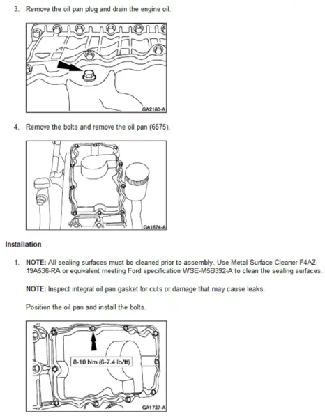

how much work is it to pull the oil pan to see if it is the guides and if so how do i replace it... ive spent alkot of time with the engine and hpoing i can do it myself...
