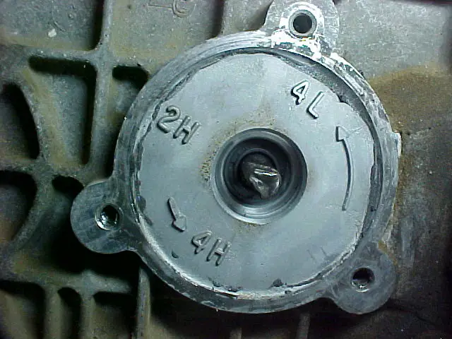

Stuck in 4L
Hi, new here and new to 4x4 stuff. I'm changing over the old Borg Warner Transfer Case and replacing it with a after market one. My 4x4 is stuck in 4L but needs to be in 2H to connect of course. So how do I do that?
Brain's post is awsome!
Brain says here: "If worse comes to worse and you are in a tight spot, you can turn this selector with pliers as you can feel the stops (it sets into place with a springy clunk)."
I can't get it to move counter clockwise like I need it to. I'm starting to round off the corners to I stopped. It's Saturday afternoon now, I need this to get to work Monday morning! Any help would be great!
Digitup
Digitup
:nono: You are turning the selector shaft the wrong way! The selector shaft only turns counter clockwise until it hits 4L.. At this point you would rotate the shaft CLOCKWISE to 4H and then back to 2H..
