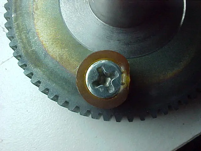

After reading through this thread (welll, half of it, anyway!), I found lots of similarities, and a few BIG changes to newer shift motor assemblies. I have an '04 with Borg-Warner 44-11 T.C., and just rebuilt it. Shifter issues caused me to go into that as well.
In case any later-model owners/workers might be interested in what I found, let me know; I'll be glad to start a similar thread in "2002-2005".....imp
If this is the cause of a motor to stop working, could you adjust the cover plate until the motor operates? After the motor actuates then remove power to stop farther action, and then readjust the plate in the opposite direction to make up the difference caused by the crushed bumper, so the gear stops at the correct point when returning to the neutral position.
This of course assumes that the unit became inoperative because the gear over shot the contact points in the unit because of the rubber stop failure.
I hope that makes sense, if so it would seem to me simply tweaking the cover plate may be an easy fix in cases like the above. My 92 Explorer (push button activation) shift motor fails to actuate and I was thinking of trying this, but would like to hear some comments if this is a good or bad idea.

I understand exactly what you mean but the real problem is the worm gear on the electric shift motor puts out a LOT of Torq. As such when returning to the 2H position the motor doesn't stop on a dime and the soft bushing prevents the worm gear from being JAMMED against the metal stop. Once it gets jammed against the 2H Metal stop the shift motor may not have the power to Un-Jam itself when you push 4x4..
OK, I guess it is time crawl under there and just take the motor off and inspect it and do a proper job of repairing it. The lazy man in me had to see if I could get out of removing the motor. It never occurred to me that it may jam when returning to neutral without that softer material on the gear stop.

I have completed replacing the stop bushing on our 1994. Had to do it twice as I cheaped out on the hose I used the first time (used hose I found lying around that fit). The first fix lasted 2 days and then no engagement again. Upon removal and inspection the hose was crushed enough to prevent it from working. I bought some gas line hose and now it works perfect. Moral of the story, use good hose. Thanks to all who have posted on this subject.
