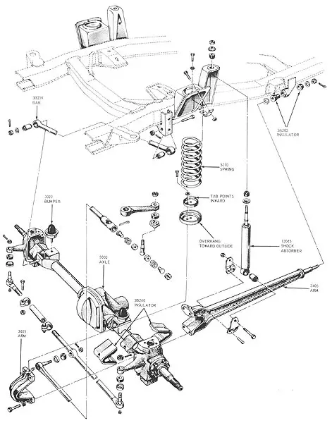

Here is a good link with some good info and pics on it.
Mr. N's
and here is a pic i have.
I used the same thing as CP, as well as my Haynes manual I got for the f150's of that year. Very helpful.
I also found these to be helpful. But What I need help is more at the beginning part of the assembly where the axle shafts come into play!

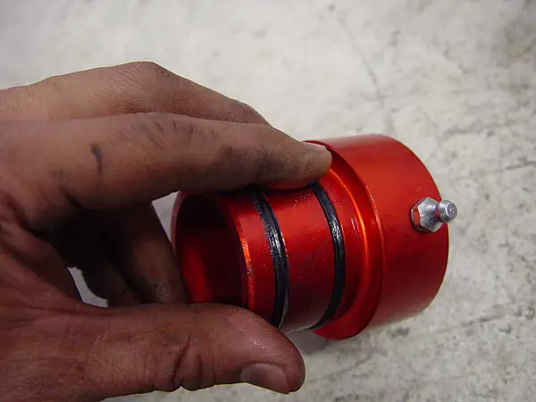

Axle seal link
Here is the axle tube seals:
Insert into tube:
Insert shaft into seal and tube:
Apply grease to seal via zerk fitting:
My dana 44 doesnt have a seal out there. I would eventually like to put one there to keep crap from filling up the axle tub.
