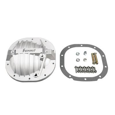

Not horrible, but I'm kinda looking for something that looks more along the lines of this:
http://store.summitracing.com/partdetail.asp?autofilter=1&part=SME-8510500&N=700+115&autoview=sku
Only without the Summit logo...
I like the lines of the Trick Flow cover, but, again, it's got a lame looking logo on it.

Most of those covers are aluminum -- which you can easily destroy with a rock. Seriously, run a steel cover and dont worry about the logos, you can grind them away if you dont like them.

I did my undergrad in upstate NY. One night, there was snow on the ground (duh), and I slid sideways into a curb after evading another vehicle that lost control. The curb chipped about a 1" triangular piece of aluminum and shoved it into the tire -- the tire of course lost its air. If the wheel was made of steel, it would have bent instead of fractured. This is the reason why most off roaders run steel wheels (other than the fact that they are cheaper and easier to modify) -- competition rigs run aluminum wheels because they have big money and can afford replacing wheels every so often. Plus competition wheels are engineered differently than regular wheels with beadlocks that helps protect the wheel.
In the end, its your call, there are a few off roaders that run the aluminum cover. But after seeing a few rigs bash up against rocks (which always shakes my nerves imagining the possibility of the carrier moving backwards), I'd prefer a steel cover.

Either way I go, I'm curious - do the "load bolts" or whatever the heck those are have to be used? I don't really see the need for them in something like my Explorer.
What do "load bolts" do anyway?
They push on the bearing caps.. In theory they help keep the bearing caps from moving (flexing) to help keep the bearings from moving/breaking/spitting out.
I don't think I've hear of anyone doing that on an 8.8 (at least wheeling).. but it is possible..
