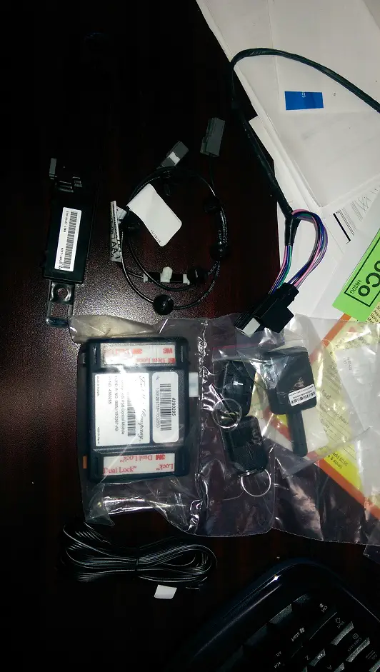

So I purchased the "Amazon kit" -
http://www.amazon.com/2011-2013-For...ote access&tag=viglink20460-20#productDetails
It came in the mail today. I feel like I am missing pieces.
It comes with what is labeled as the VSS Control Module, what looks like an antenna of some sort (long skinny device with one square grey plug", 2 key fobs (I dont have to use these things right?) and another item specifically labeled as the antenna receiver, along with 2 cable harness and 1 cable for the actual labelled antenna. The only instructions that came are labelled "Remote start system".
No shock sensor (unless that is what the long skinny thing is - but its just a circuit board?) and nothing else. Did I get the right stuff?
*added photo of what I received*

That looks like a kit someone put together for the remote start. From your picture it looks like you got the VSS, the extended antenna which from what I have been told you only need if you have the 2 way remote fobs. It also looks like you may have a hood switch kit as well.
On my VSS the shock sensor is in the VSS and there is a sensitivity knob on the side. What I do not see is the "Y" cable which ties into the ODBII connector.
I wonder if you might have one of the older kits.

There are two sets of instructions actually. The sticky is for the original one which required running cables to the rear of the center console and disassembly.
Benny, in post 197 posted the part numbers for the new modules and if you click on them there is a link to installation of the new modules with the ODBII "Y" cabling. Much easier to install and do not have to disassemble the console. Maybe we could sticky those instructions as well??

Thanks. I have mailed the seller to see what the deal is. On this VSS, there is no gain knob. Nothing has a sim card or access to a card (opened everything up completely). Pretty sure this is the incorrect kit. The part # referenced on the amazon link I purchased from matches that which was listed as the "complete kit" on previous posts.

I have the iphone kit and they sent the wrong thing. TOTALLY WRONG!!!!

Look at post #197 in this thread. Benny posted 2 links to the parts needed to be installed for the smart phone app remote start. one of the links also has the install instructions for those modules.

I did, and I received the correct kit. They probably just made a mistake with yours. Their phone number is listed on their Amazon profile page.

It looks like you received the old kits that are no longer supported and extra fobs too? The kits we sell are the latest available and plug into the OBD port, No antennas are need with an RMU installation.

That's not even the old kit. It looks like that's some kind of kit for adding a full remote start system to a vehicle that doesn't already have it at all.

Yeah perhaps a 1-way extended range kit. If you are looking to add the cellular remote access to your Ex I would return those and purchase these 2 items:
http://www.levittownfordsupercenter...mote-start-system-cellular-access-p-2270.html
http://www.levittownfordsupercenter.com/ford-explorer-vehicle-security-system-p-1881.html
Installs in approx 20 minutes and I will activate it over the phone for you:thumbsup:

I bought from Banner with no issues. As others have said, that is not the correct kit. I have talked with Banner via phone a few times, instead of waiting for an email, pick up the phone and call them.

Just bought from you Benny - finally got a hold of someone over at QuirkParts... After being on hold for 10 minutes while they tried to figure out what happened and where the proper part was and hearing about how the guy "wished cars didn't have all these gizmos and do-dads" AND "How he hates the way Amazon makes them list their items" I was over it and told them to send me a RMA and I'll locate another option.
As an aside, while we were on the phone I realized the part # I was shipped was CL3Z***** instead of DL3Z* - so they simply shipped the wrong box. Why it took so long to get that figured out and communicated - beyond me.
Happily waiting for new pkg to arrive, hopefully with correct parts :-)
