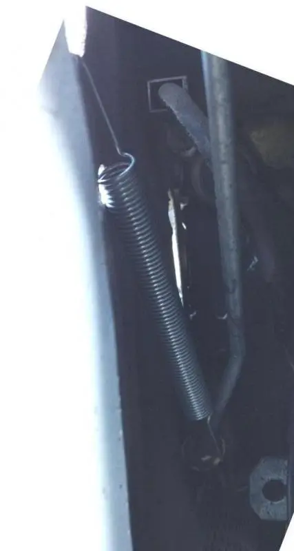

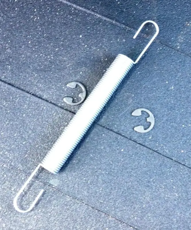

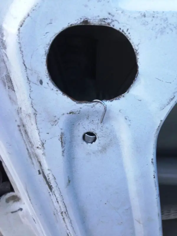

I had the spring issue as well. However, I noticed that if you lift the arm that goes to the handle up a bit, the problem goes away. I assume that the spring takes care of that normally. I tested my theory with a rubber band, all good. So for about $3.50 I bought a spring at Lows and installed that.
So far it works well. I had to bend the spring ends a bit and add a loop of wire but likely ACE or Dale Hardware would have had a better spring selection.
The handle has two places for the rod attachment but only one is used since it goes on both sides of the car. I attached a spring to the unused side. The other side goes to the bottom of the rod where the plastic connector is. Just make a loop of metal to go around it and hook the spring. It only took about 5 minutes to install. Just make sure to get a light duty spring.

I had the same experience. The door was more likely to unlock when I gave the key a firm flick. I could see the little broken spring in the latch. I hooked up a spring where the lock/unlock rod connects to the latch, the other end to the door sheet metal so the latch is biased "up" by the spring. $2.64 fix.
(I didn't need the little retainers after all.)
Moving the top of spring right or left had an effect on how well it worked. Make a groove when you find where you want it.
