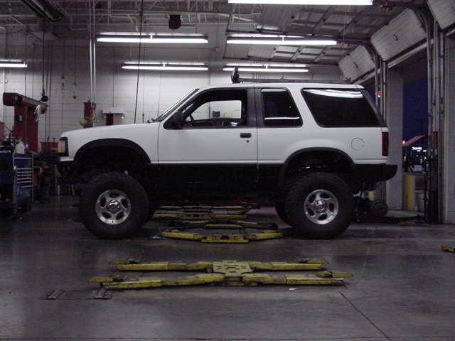

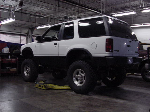

Let's start with what the Nasty Hoe looked like when I started this venture:

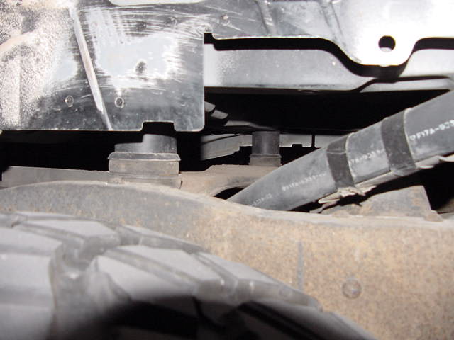

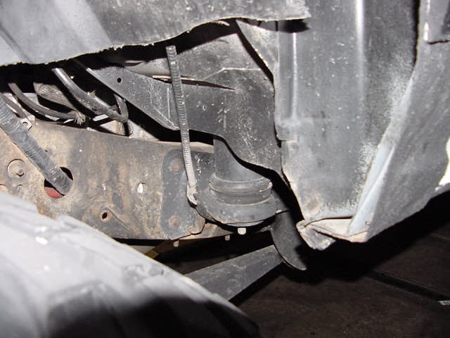

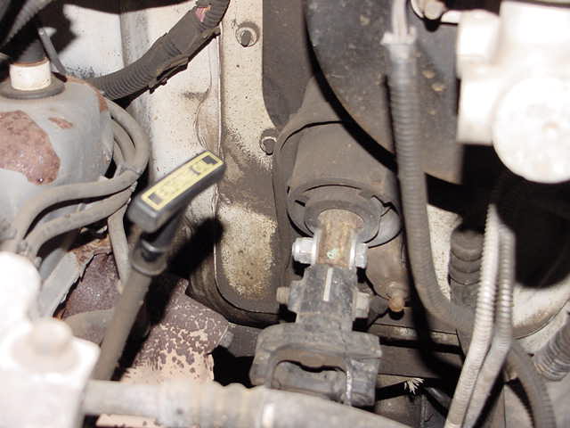

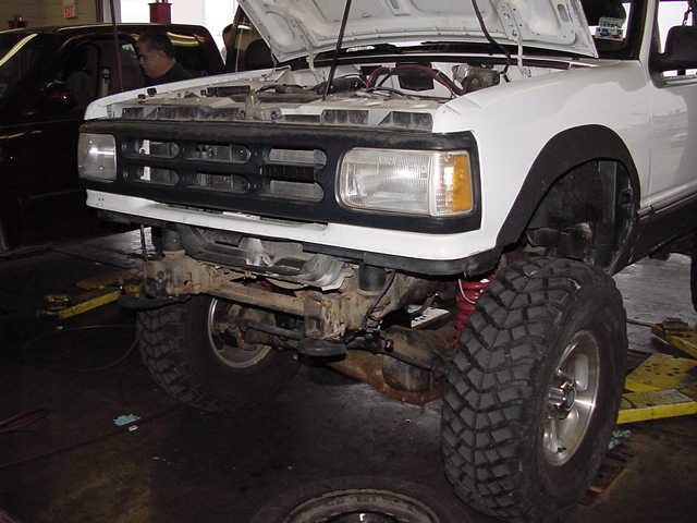

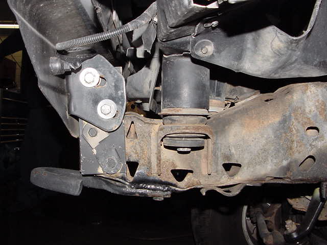

What you see in these photos are some of the positions of the 3" pucks, and notice that the E-Brake cable is in a bind, I was never able to use it while the BL was in place, that sux when you need to stop on the trail and get out.

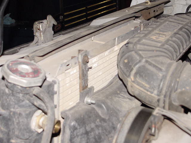

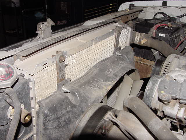

These pictures also show the relocation bracket for the fan shroud and the extension for the steering shaft.
The fan shroud brackets and the steering extension were the first things I took loose, you have to remove the intake hose for the radiator brackets.

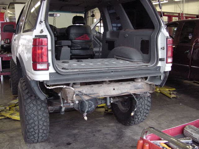

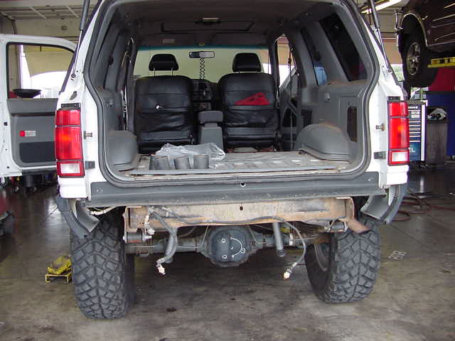

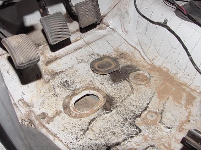

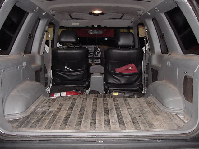

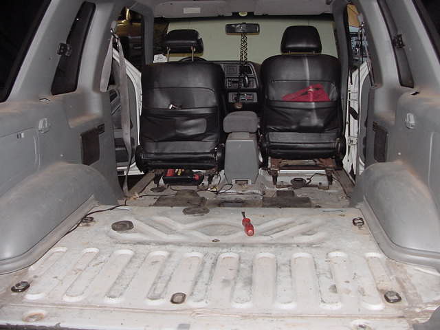

Next came time to remove the flooring in the back and pull out all the body plugs to access the body bolts, now here's where I cheated, because I have 97' Toyota Celica GTS seats in my rig, it uses the standard Explorer seat tracks WITH the Toyota seat tracks welded on top, so I can infinatly adjust the seats forward and back which means my seats DO NOT have to come out. :p

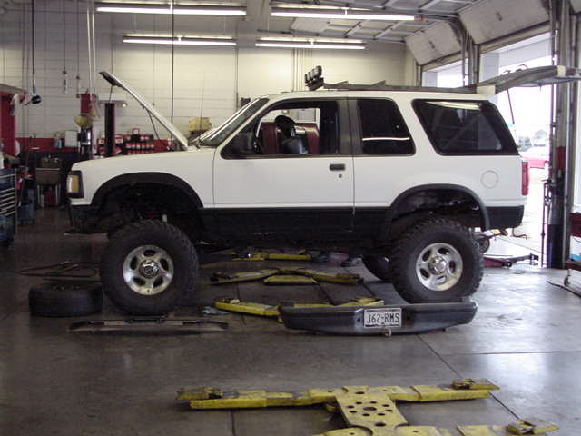

Once all that was done it was time to remove the body bolts and raise the body up about 3/4" to pull the pucks out.
This time insted of having 6 guys lifting one side of the truck, I cheated again and used the lift at work.
once they were all pulled out I lowered the body back down to where a 1/2" of clearance was allowed so I could "nudge" the body if need be to get all the stock bolts to thread up and go back into place.
Then I set the body completely back on the frame and tightened them up.

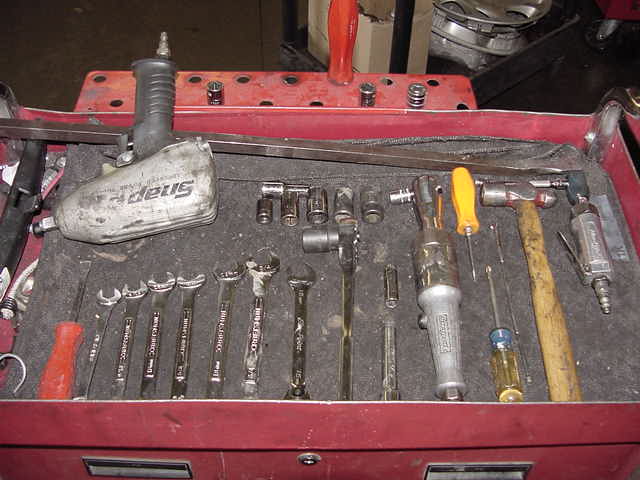

Here is all the parts I removed and all the tools I used to perform the job.
It took me an hour and half this morning to do it by myself, I suggest most people should have help to do this.

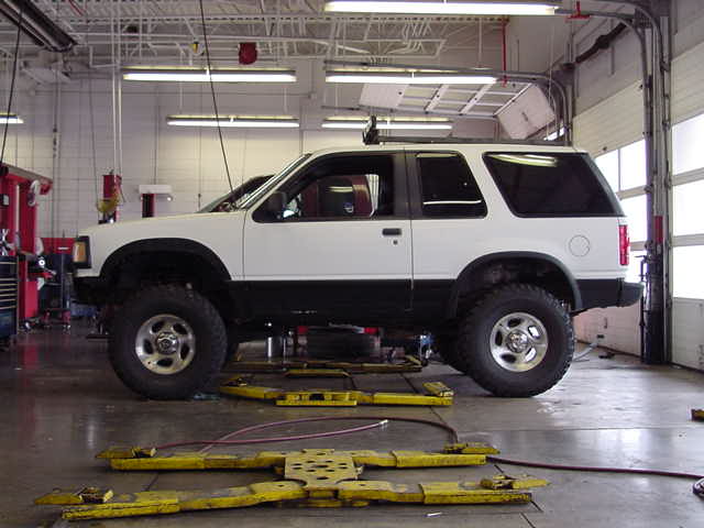

And here's what the ole' Nasty Hoe looks like wo/ the BL.
Good Luck and Happy Wheeling! :D
