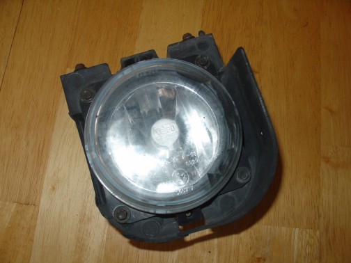

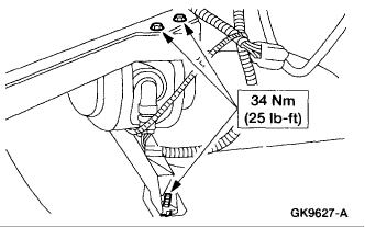

Its very easy to remove the housing.
You just remove the 4 bolts ( 2 in the drawing and in the photograph ) and disconnect the electrical connector ( 1 in the drawing ).
I don't think the glass is a separate part. You will need to purchase the entire housing.
