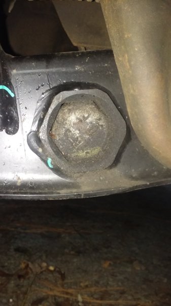

This is just one of reasons im changing every control arm.
Yes, that is day light you see and no, I'm not 100% sure what what caused it. But that doesn't matter. As I said that is just one of the reasons. The other two reasons are bushings and to change the two piece UCA and make it a one piece.
As for the torsion bar goes, would you replace it after putting in new LCAs? Do you think you run the risk of having the same issue down the road?

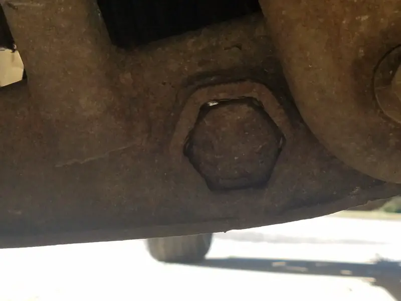

Wow.. Now you have me anxious to get home and check mine!.... following
When you take it off you can check how it fits in the new control arm. IMHO that torsion bar is not going to twist in that control arm anyway at least not yet. Looks like the control arm rusting and losing some of it's metal, flaking off in where the torsion bar sits. IDK.
I replaced mine about a month ago, my LCA had some bad bushings, my torsion bar was rusted in there real bad and had to cut it to get it out.

I'll be changing out my lower control arms also. The bushings are shot and lower ball joint has been replaced on both sides 3 times in 5 years , the last time with Moog problem solver parts and still having issues. This time I decided to get a set of "Detroit Axle - Both (2) Brand New Front Lower Driver & Passenger Side Control Arm and Ball Joint Assembly for Torsion Bar Suspension ONLY" From Amazon. I was warned that the torsion bar would be fine to re-use but not to attempt to heat it to get it out of the control arm. Heating would remove the "temper" from the spring steel. Cutting it out is the best way if hitting it with a hammer doesn't break it loose. Although with the sunlight shining through yours I don't think a tight fit will be an issue.

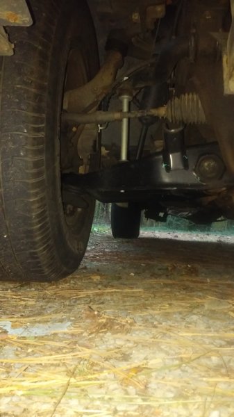

I went with the movoteck I am very happy with them exactly the same as my oem metal thickness nice ball joints and nice bushings too
Nice part
There is nothing wrong with your springs either
One tap with a ball hammer there out
And no that's not rust it's road grime on my truck the fluid film kinda collected dust and stuff
