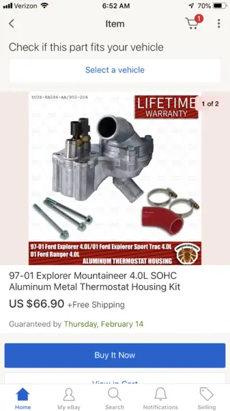

This seems like a deal?
I installed one of those, it leaked right away. The Simmons I replaced it with does not leak.
If you want to do this difficult job once, spend a few more dollars and install a Simmons.

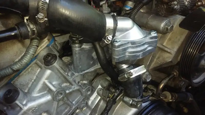

I did not remove the threaded heater hose on top and reseal with the correct RTV, that is where mine leaked. It should not be necessary to do this on a new part.

It takes a hour if you are experienced on working on cars it's not hard at all just remove the alternator and bracket and it's right there

I removed the alternator and it's bracket like in the pic above its right there I didn't even think to remove the intake
